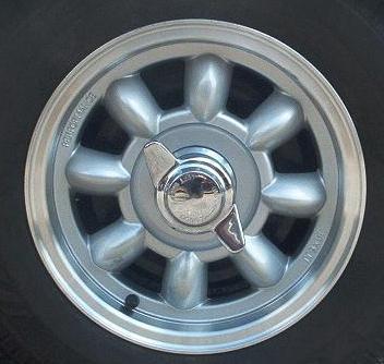

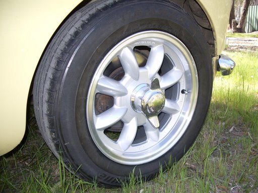

If you end up running alloy spline drive wheels, call me, I can help you out, we're clearencing these right now, I got 14x6 and 15x6 in stock.
