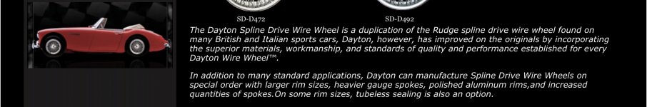

Dayton wire wheels all have a generous bead of silicone spread over the spoke ends inside the rim so you don’t need inner tubes .
not sure about other maker of wire wheels . You could just add an inner tube .

Using sealant at the base of the spokes creates 48, 60 or 72 potential leaks depending upon what kind of wheels you have.
For the record I have always used tubes and have only experienced one tube failure in 21 years/75K miles.

I had Dayton wire wheels (72s) on both my BJ8s , no tubes never had a leak on any of them .

A look at the Hendrix Wire Wheel website shows the following statement under services they perform in prepping tires for mounting: "Dusting with baby powder prevents tube chafe."
The question is not whether you can run wire wheels without tubes but rather why do so?
Healey Nut
Another look on Dayton wire wheel site will find you this .
so to answer your question the answer is because you safely can go tubeless .
