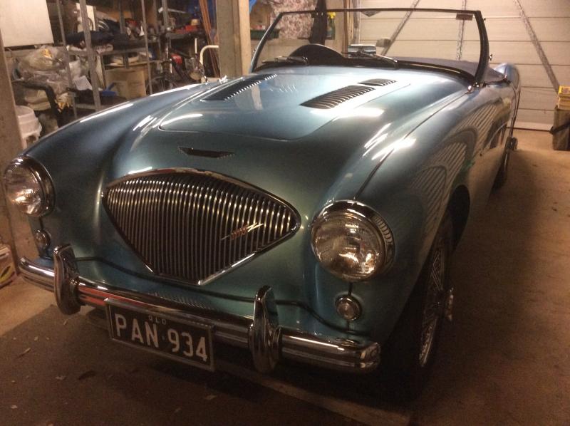

I fitted Indian made Dunlop chrome/stainless 60 spoke wheels to my 100 over nine years ago. The reason that I settled on this brand instead of Daytons was basically because of price. In Australia there was a 25% price difference per wheel. Some years prior to fitting the new wheels, I had needed to buy a painted, 48 spoke Indian Dunlop wheel and while I had trouble with other wheels the Indian Dunlop never gave any trouble with loose or broken spokes, or running out of true. I still have this wheel in the boot as my spare. So I thought it was worth a punt. I have not regretted my decision, but I should add I have had no experience with the Dayton product. In the last nine years I have completed six interstate trips covering distances from 2,000km to 5,000km, with lots in between! ( If you are familiar with Australia, you will know we have big distances between our major cities). All I can say is that the wheels have never given me any cause to worry and they still look as good as the day I fitted them. How's that for a testimonial?
