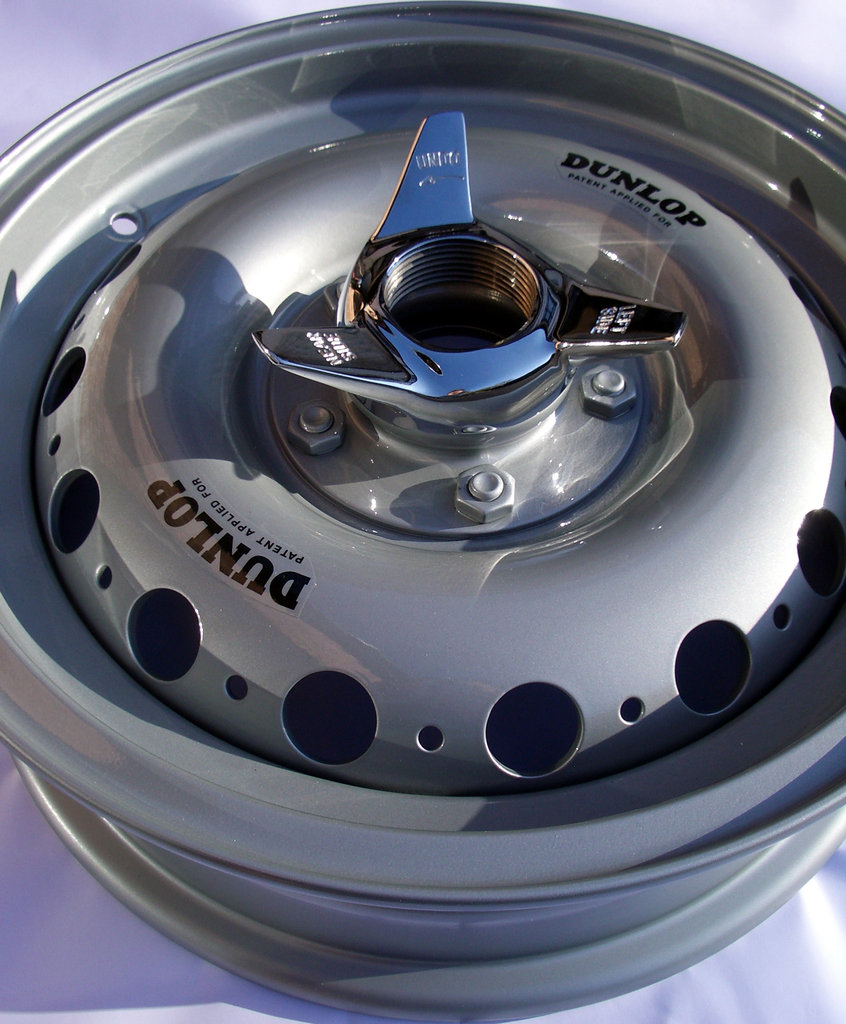

Kenneth, This photo doesn't answer your question for the Dunlop paint code - but I thought I'd put it up because it does show that silver/gray color....and I've always thought it's a cool picture.
