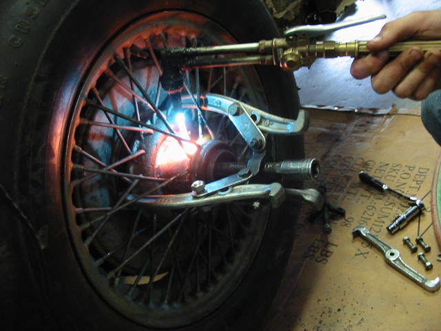

It should be possible to find a puller that will fit. This picture is from a Healey with 72 spoke wheels too.

kozelding
Though, I'll add in my experience, any time a wheel is "hard" to put on, it's really hard to take off. Shame on the shop for pushing them on anyway.
For the hammer route, you really have to be under the car, so you can hit the back of the wheel squarely. On modern cars, I've used a long piece of wood and a sledgehammer (to tap the back of the wheel from the other side of the car), but I suspect with wire wheels, you start to really risk bending something at that point.

kozelding
Yeah, Bob, the picture ^^^ was to show an example puller - not how to safely apply heat!
That was a rear wheel on a very worn hub, which, I believe, became cross-threaded on the splines while driving, and then sat in a damp garage for 20 years. The picture shows a last-ditch effort before the Sawzall comes out; both the wheel and the hub are no longer with us. Hopefully fishyboy's removal is easier.
HealeyRick
That's a cutting torch. I'd be pretty careful with it.
That'll get it off. Having grown up in Massachusetts when Healeys were used through the winter with lots of salt on the roads it was not uncommon for wires to be cut off with a torch if they hadn't been regularly serviced.
