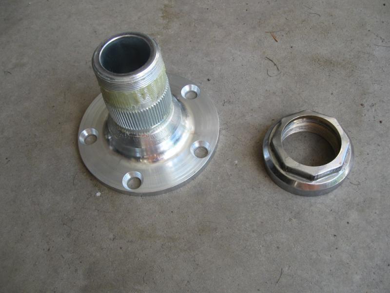

Agree with everything that's been said. When you get ready to balance them, they probably won't fit on a modern spin balancing machine. To solve this problem, I modified an old hub to server as an adapter. You'll need to find a cooperative tire shop and machinist, but with a little work you can modify the hub to fit the 'cones' that hold the wheel in place. It took me a few trips back and forth between the tire shop and the machine shop, but I eventually got it right. You'll have to have the machinist remove the center from the knockoff nut so the cone will fit down the center. I can send you a picture if it would help.

John,
I never made it out to my shop today, but here is an old picture that I found. I doesn't show the machined surface on the back side, but at least you get the idea.
Keith
B
bluegrass john
Thanks for the picture and also thanks everyone for their informative responses. I have located a race shop that has a Hunter revolution tire changer that is completely automatic and nothing touches the rim. I checked a video on you tube and it looks like this machine is exactly what I am looking for to dismount my tires: amazing to watch this machine work on the video................let's hope it works this well on my 60 spoke Daytons.

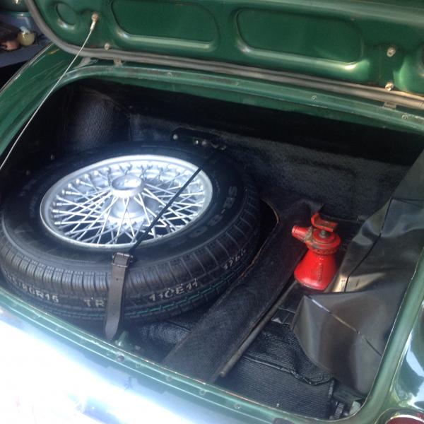

image.jpgHello John, I just got around to reading your post and thought I would chime in a bit. I don't know if you already bought tires and tubes yet? But if I may, I can suggest a few things that worked very well for me and saved a boat load of money in the process. I bought Nexen tires for my BJ8 after hearing some really great reviews. After 6000 miles I can tell you they are the best all around tires I had on any of my British sports cars period! AND they where only 50 bucks each when I ordered them at super Walmart tire dept. these tires are the proper look and scale and look right on a Healey. As for tubes, order them from Summit racing, they are only $8 dollars each and very good quality, super fast shipping too. As for mounting the tires and wheel alignment, I went to my local NTB and talked to the manager and the guy who was doing all the work so they fully understood to take special care when mounting and balancing.... Bring a spare tube just in case they pinch one. Well, all in all they did a great job as I watched them. As a result, my Healey tracks straight as a arrow and smooth at all speeds! Had it up past 100 mph one time and no problem at all. Hope some of this info helps.
