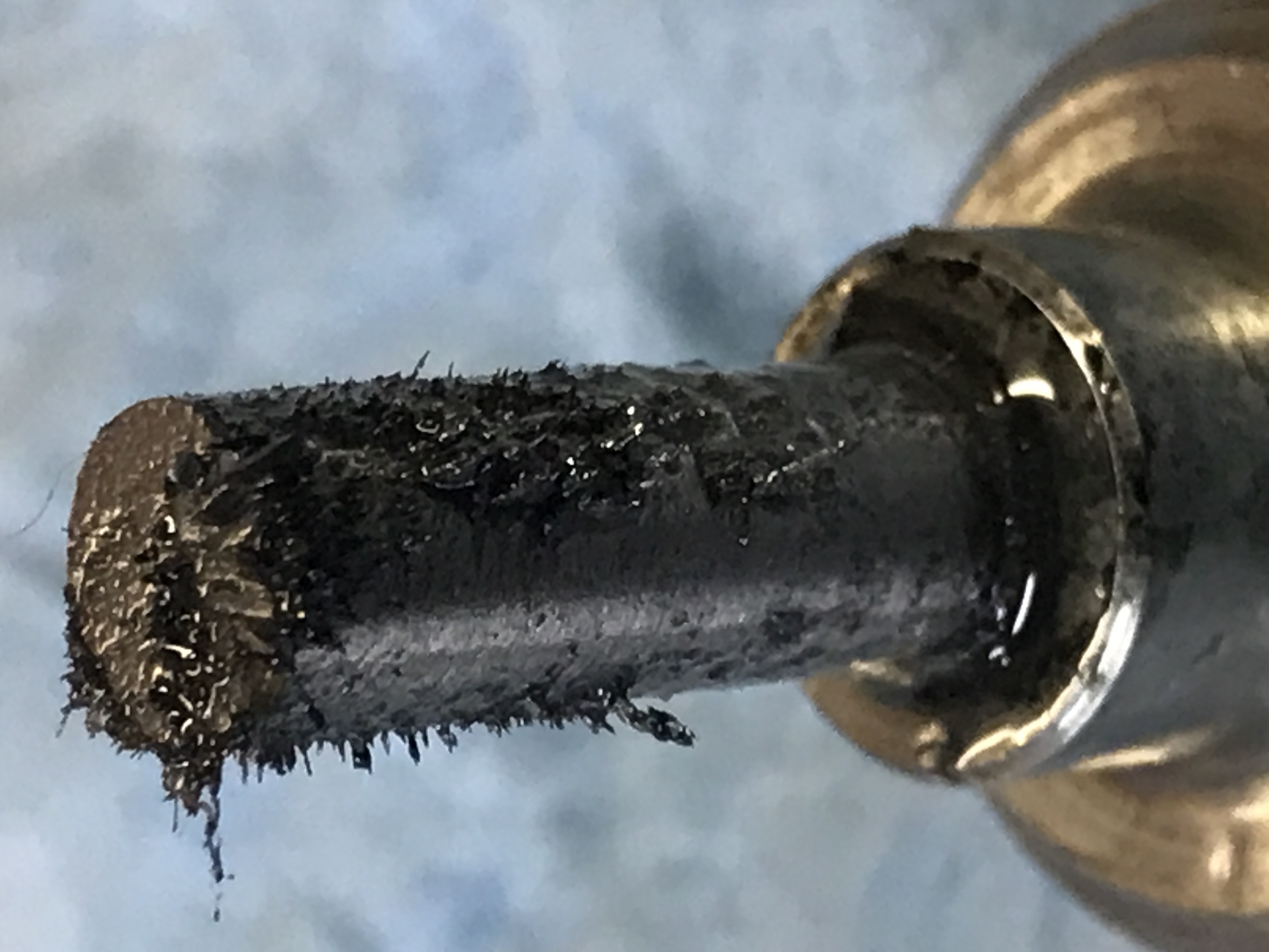

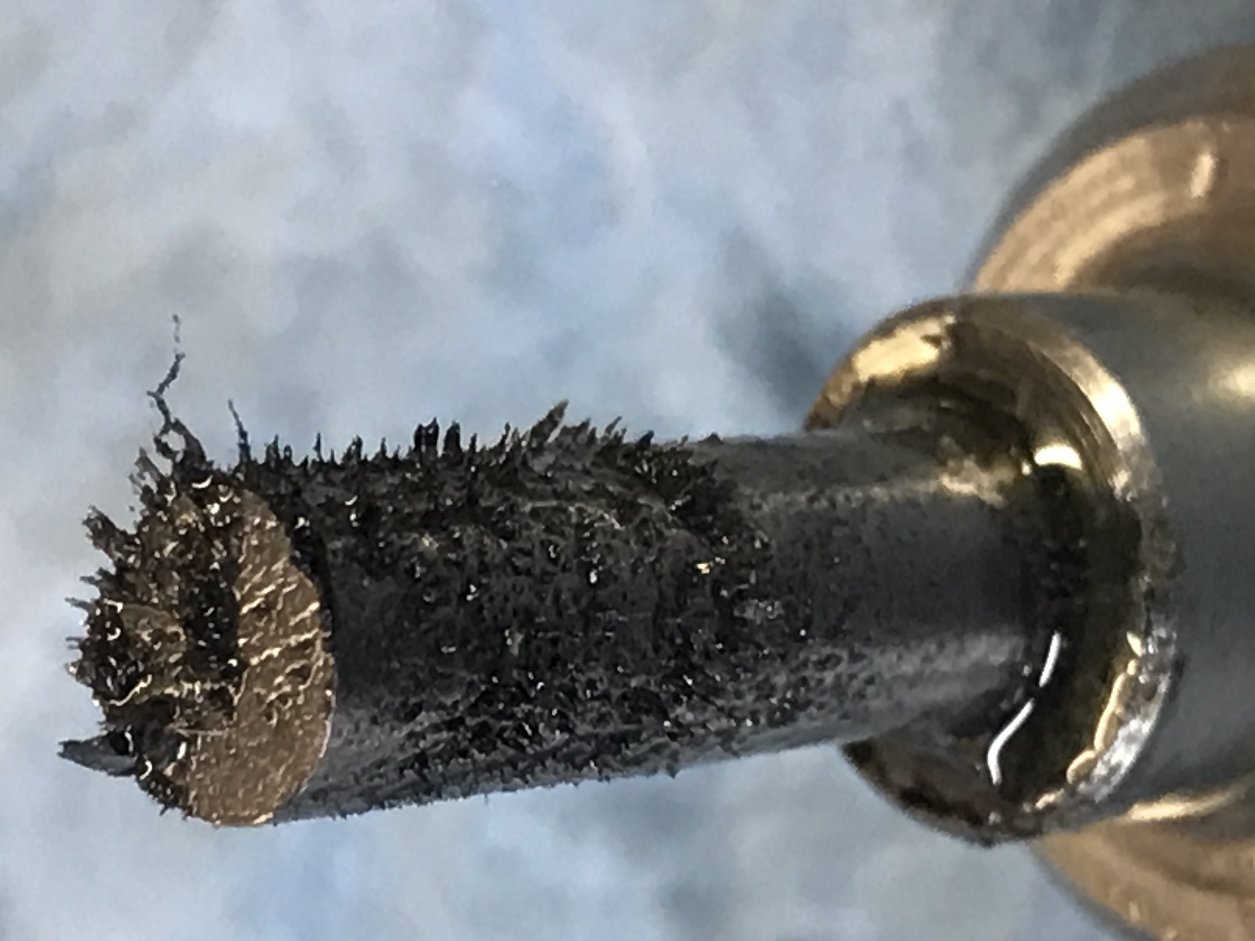

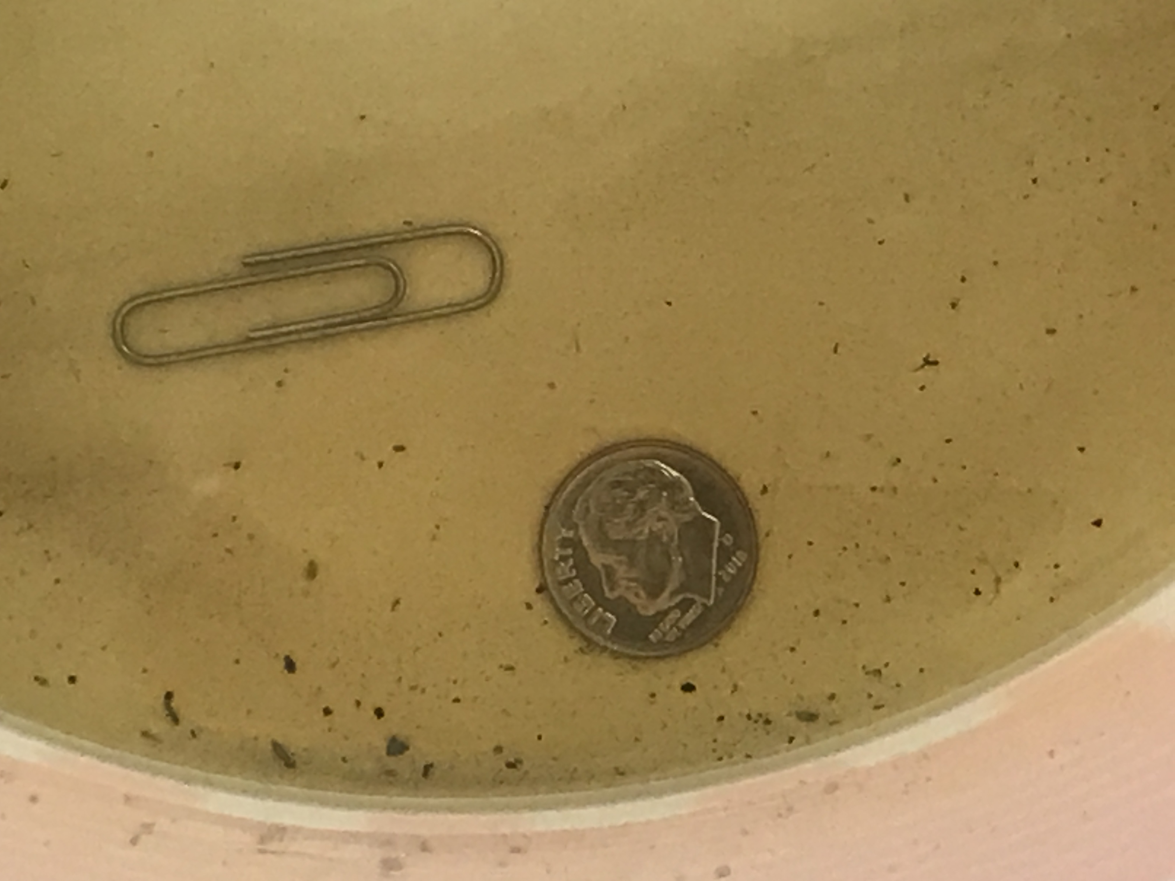

I drained the oil. Findings were, metal filings on the magnetic drain plug, small pile of bronze in the bottom of the tranny. I painted the internal case with Glyptal Red paint and all gears where cleaned. I see debris in the oil, some looked like gray RTV which I believe was coming from the OD. (I used blue Hylomar.) The OD was working fine so I didn't touch it.

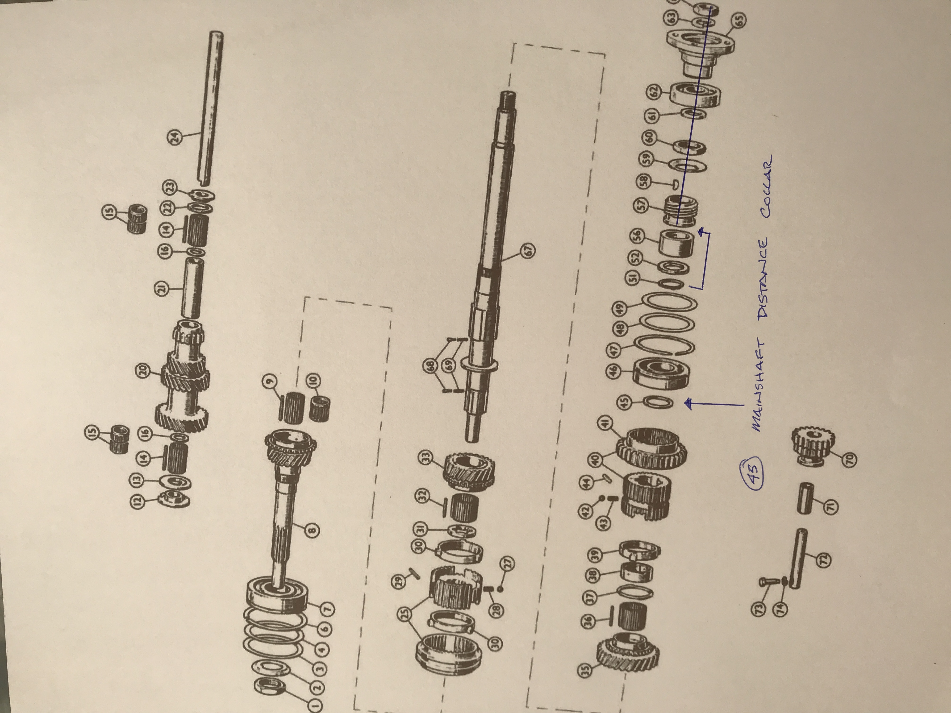

I watched a Youtube BJ8 rebuild by Magnus Karlsson “Boras” where he places the 1st gear assembly on the main shaft then says “ Here come the spacer ring which is very important but can easily be forgotten”. (Is the "spacer ring" is also called the “distance collar” ?)
I don’t know if the spacer ring was installed. What happens if I don’t have it? Should I? The AHS diagram (color) doesn’t show it. The Moss does.

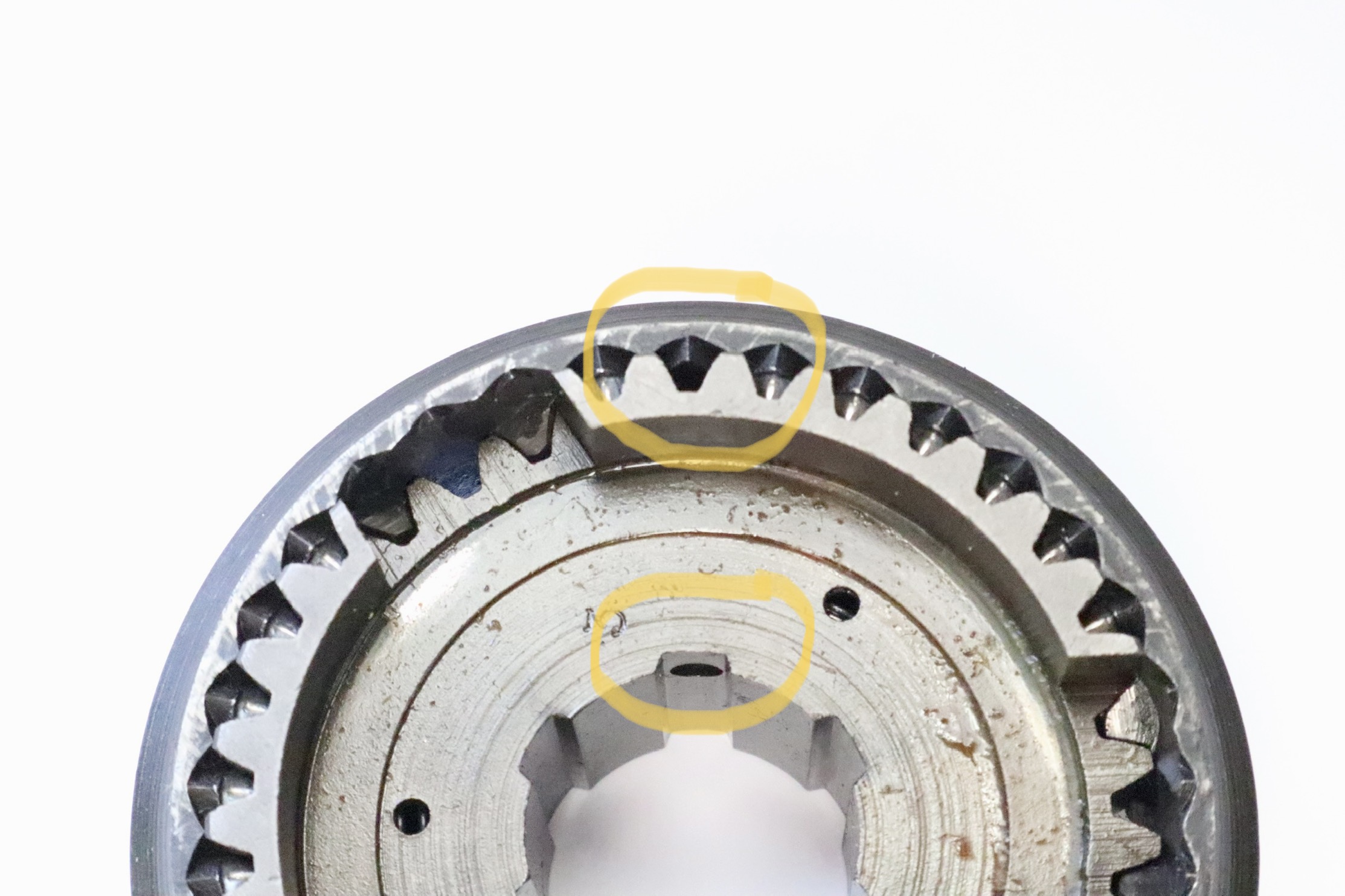

3. In the coupling sleeve of 3-4 you have 2 small pins. In mainshaft splines you find 2 cut outs that these pins must match. Furthermore there are 2 cut outs in the outer sleeve engaging teeth’s that shall match these pins. If not correct mounted will engagement of 3-4 be difficult. What you describe indicates wrong positioning, I know from experience.

Here is example of measurement I made when rebuilding my gearbox (input shaft bearing, in mm).
The language is mixed, hus = housing, packning = gasket.
When the OD and Clutch Housing is mounted can geometry be changed, flat surfaces etc exist only in theory.
The earlier Healey gearboxes had a 1 mm deeper grove in housings where a preload washer can be used, BJ8 gearbox do not have this feature, I guess it was a rationalization.
When accelerating the helical gears will apply force pressing both main and input shaft bearings against the gearbox housing, de-accelerating the opposite direction but with much less force. Pre-load washers was not a bad idea, but the feature is not for BJ8 gearbox.
Correct that the part list has two shims, but quantity is set "as required"
Both bearings are in mm, easy to find suitable shims on the net. I have bearings 6307 (dia 80 mm) rear and 6308 (dia 90 mm) front, there are different qualities of these bearings, I bought from Denis Welch, are very good ones.

Did your oil look like this?
but if it's tough to shift..
After a break in you should have some filings

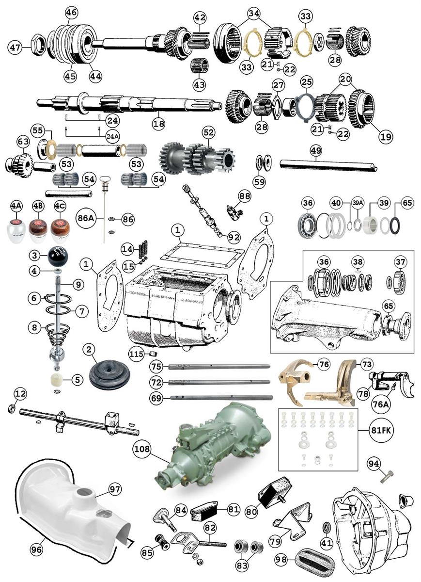

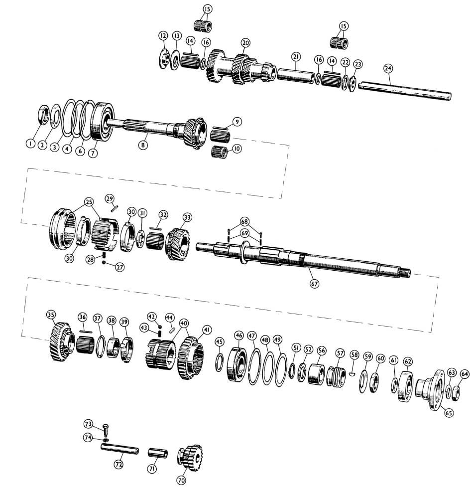

What is a coupling sleeve? Moss #25?
Are the 2 small pins called a plunger? Moss #29?
In mainshaft splines you find 2 cut outs that these pins must match. Moss #68/69 position?
Would you point out these parts in the attached Moss diagram.

Hi

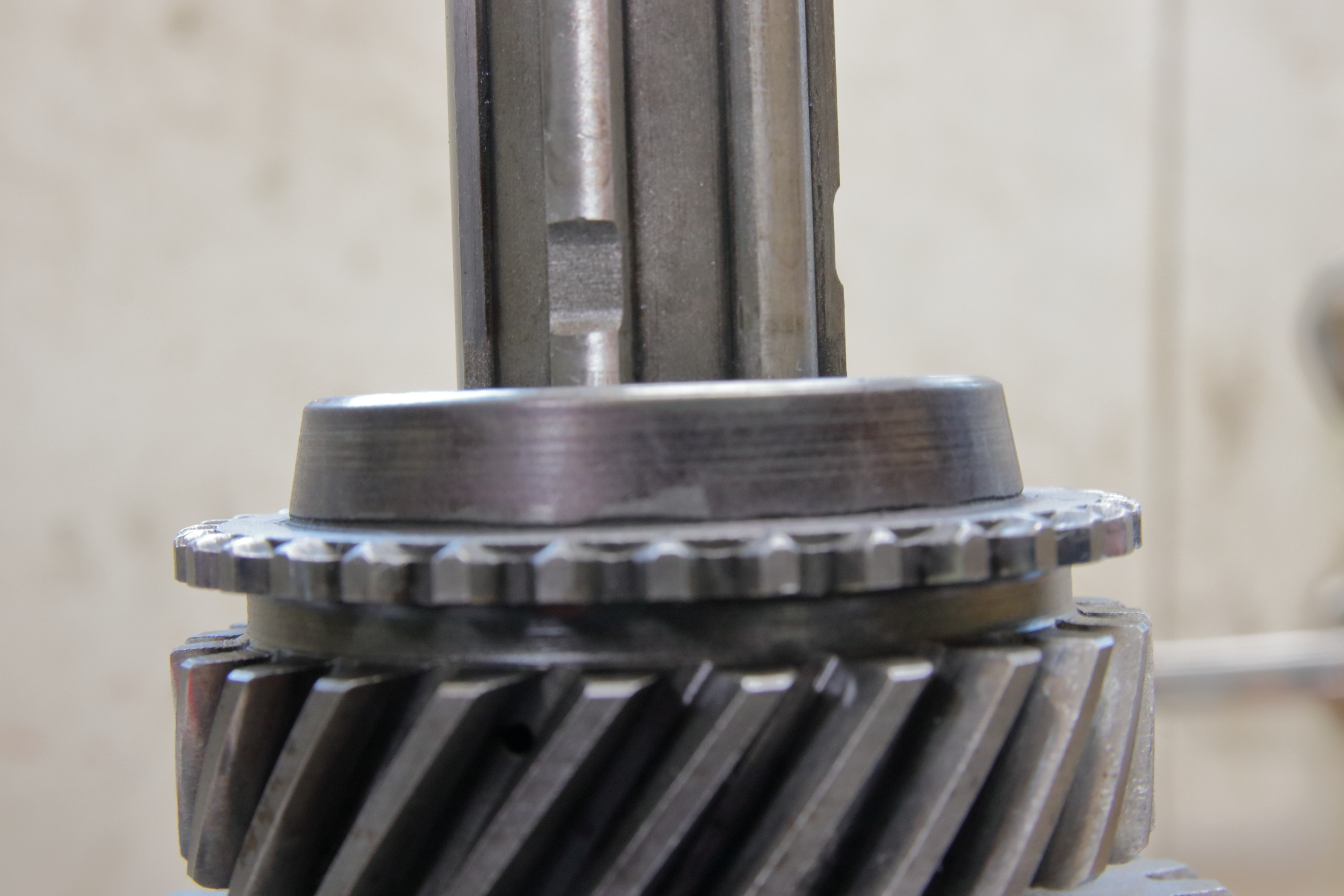

The 2 small pins are item 29 above.
The Photos attached shows details:
- inner hub has two radial holes for the pins
- outer sleeve has a recess made on the engaging teeth. The same is done on the opposite side matching the second pin.
- the main shaft splines has matching recesses for the pins.
This can only be assembled in one way to have the pin’s matching the recesses.
note that I have coloured the sync cone to check the alignment to sync ring by rotating the sync ring by hand.

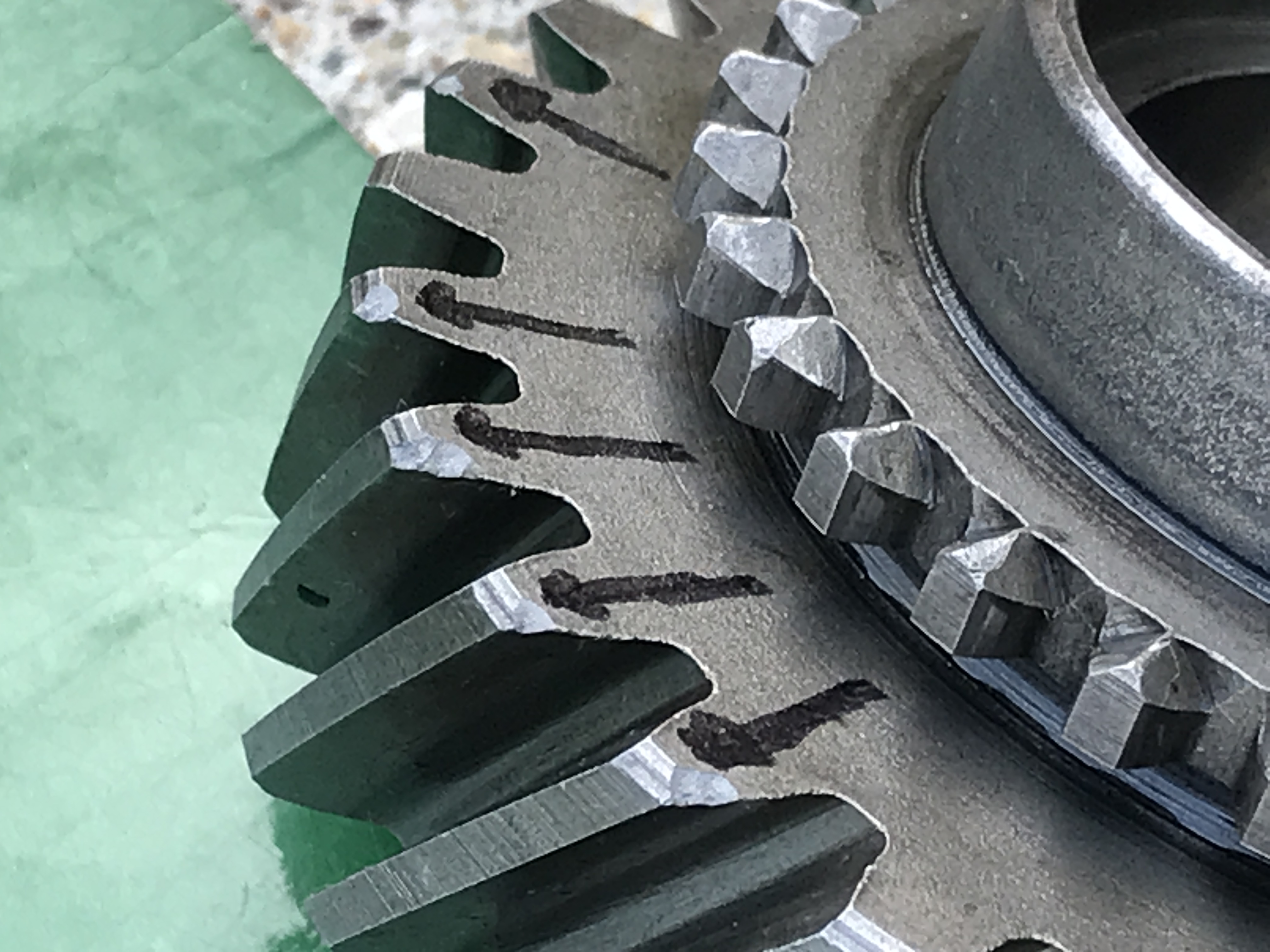

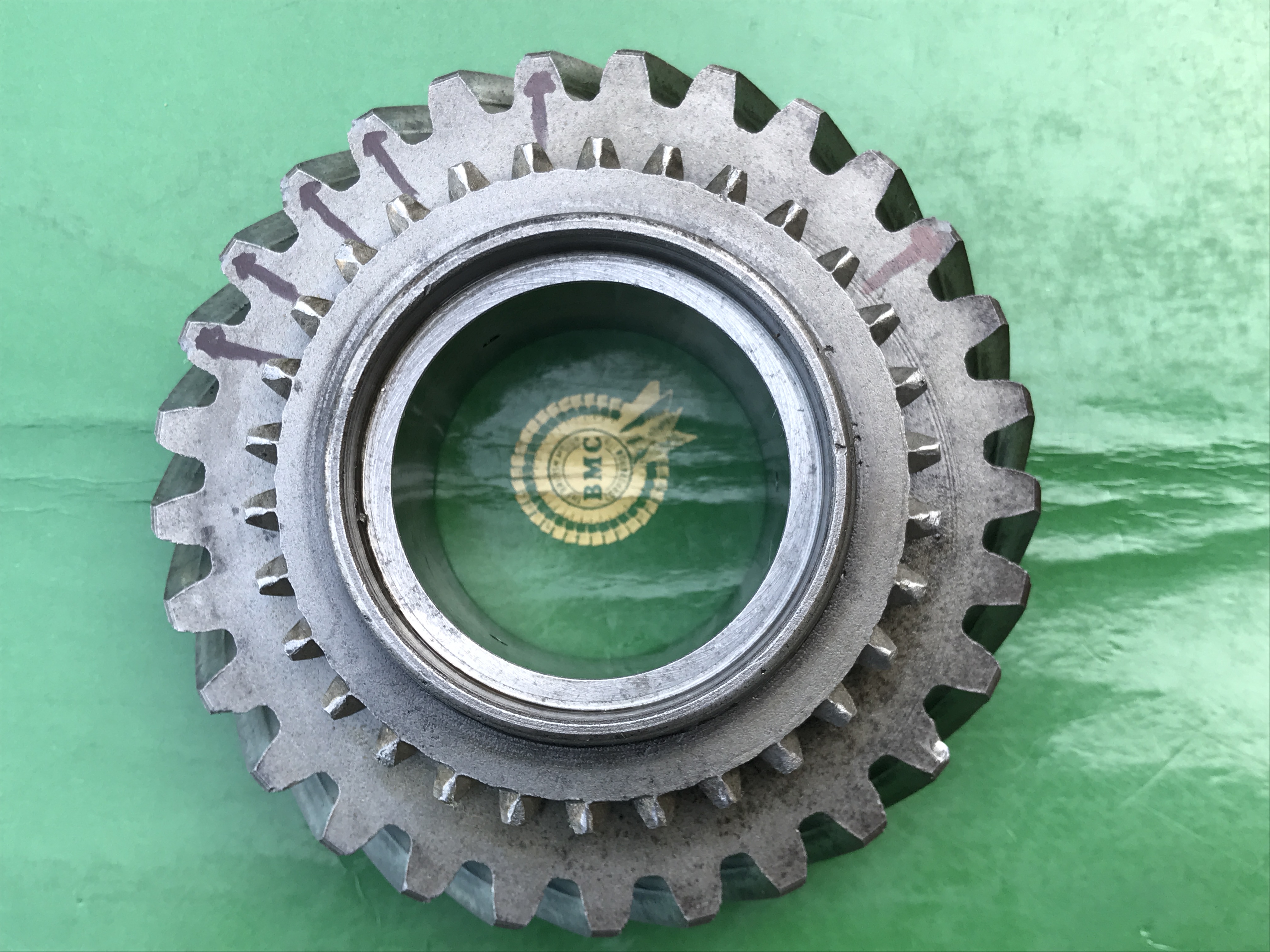

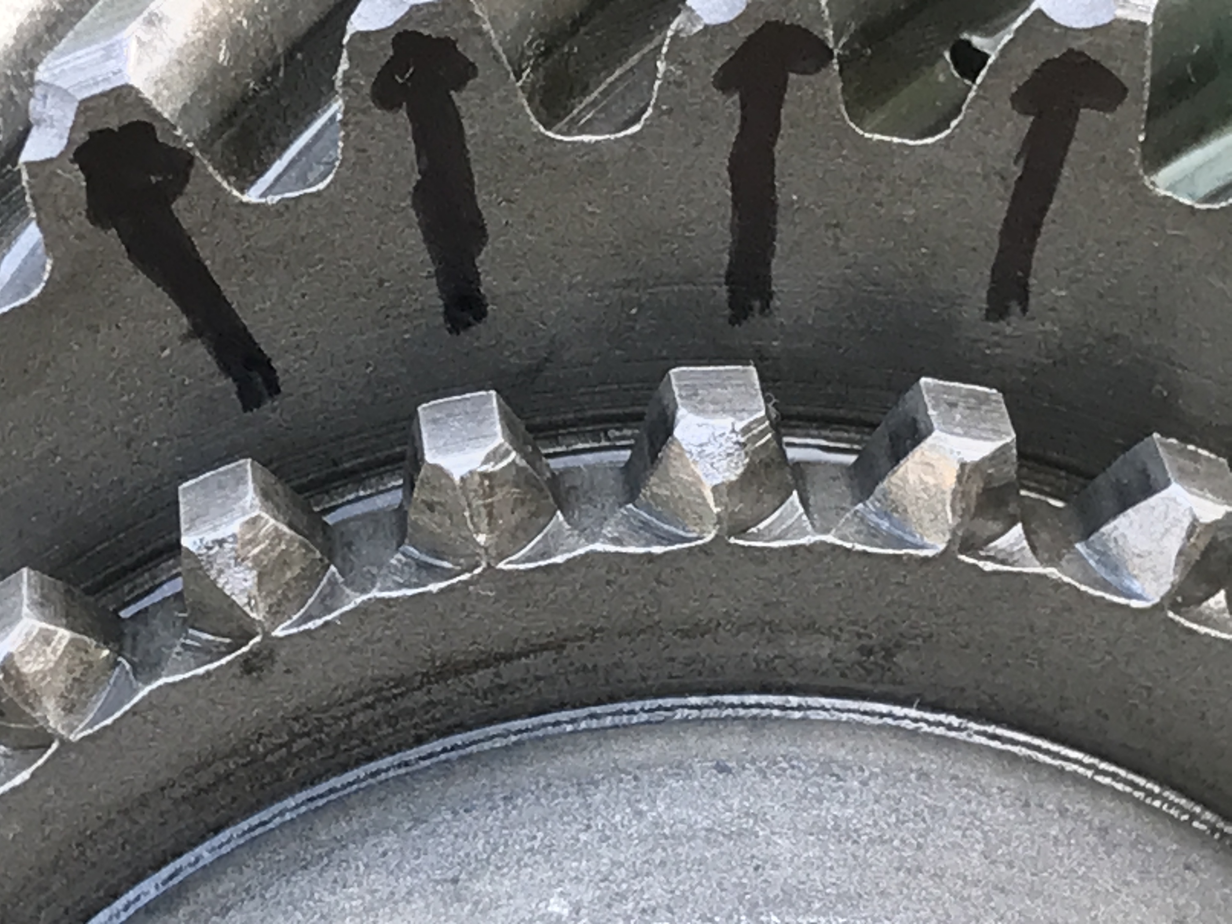

Today I took all the gears out to find out where the metal filings are coming from. I found 2nd gear has 6 teeth with a chip on the end. I'm concerned where those pieces are. I didn't see them when I drained the oil. Also the small teeth seem to be getting damaged.
The new laygear doesn't show any damage to any of it's teeth. I now know I have too much end float, measurement shows 0.015. I'll be correcting that to 0.012.
Would excessive Laygear end float cause the loud gear noise and damage to 2nd gear?
I also found 1/2 and 3/4 selector rods were bent and wear on 1/2, 3/4 shifting forks. That explains the hard shifting. (I'm replacing those)
Could that also be the cause of why all the gears sound louder?
What is causing 2nd gear's teeth to chip?
