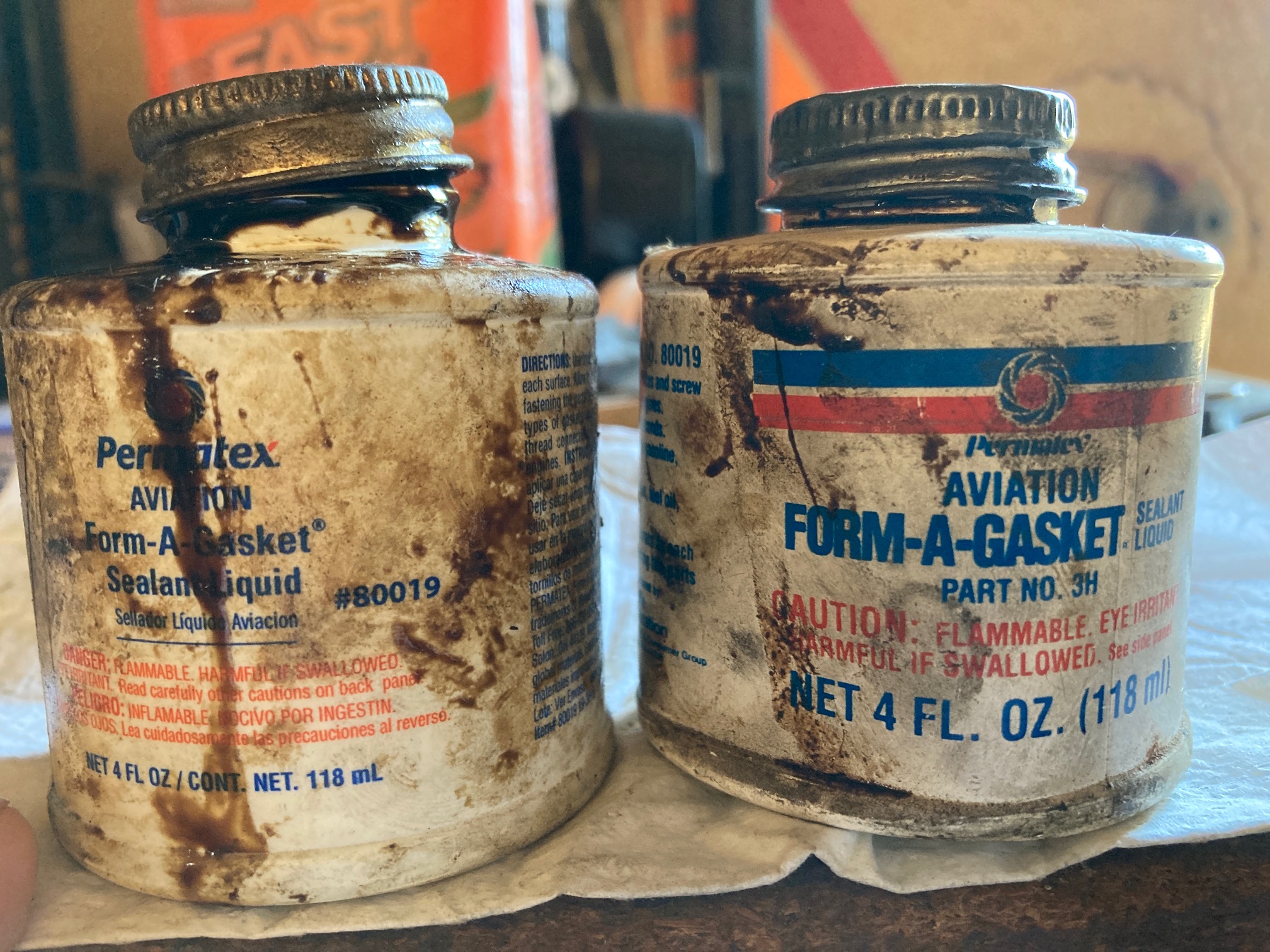

Thoughts on:

Permatex 80019 Aviation Form-A-Gasket 80019

I used Form-A-Gasket on my gearbox to good effect. I use it exclusively on paper gaskets; in fact, I used it yesterday on an engine coolant valve gasket. Thin coat only; done right, the gasket will peel off intact if you have to disassemble again. Permatex has two part numbers for, apparently, the same stuff; anybody know the difference (guessing '3H' is newer)?

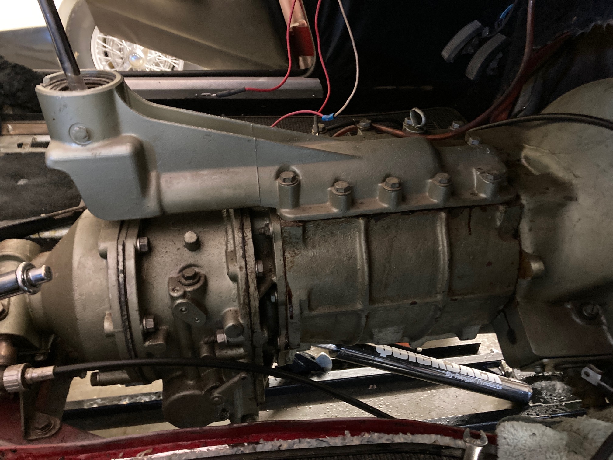

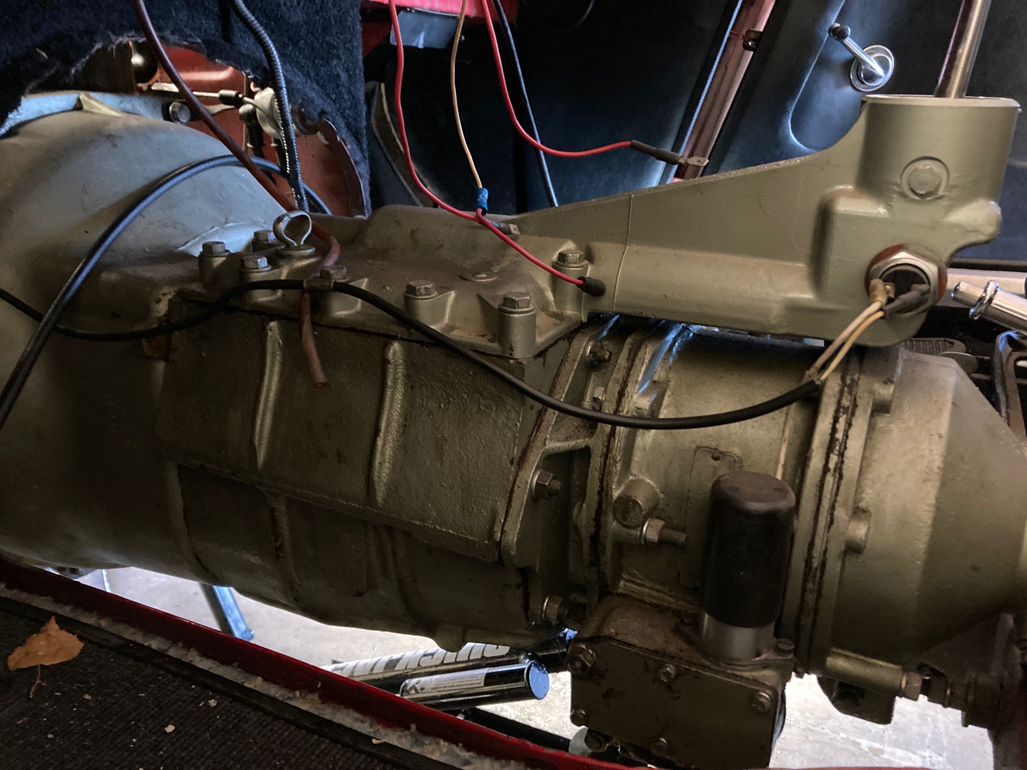

FWIW, I had my gearbox cover off to replace a heater valve (last one only lasted 35 years). All paper gaskets have a thin film of Form-A-Gasket; brake ring has no gasket--not supposed to have one--but thin film of an RTV (done about 7K miles ago):
