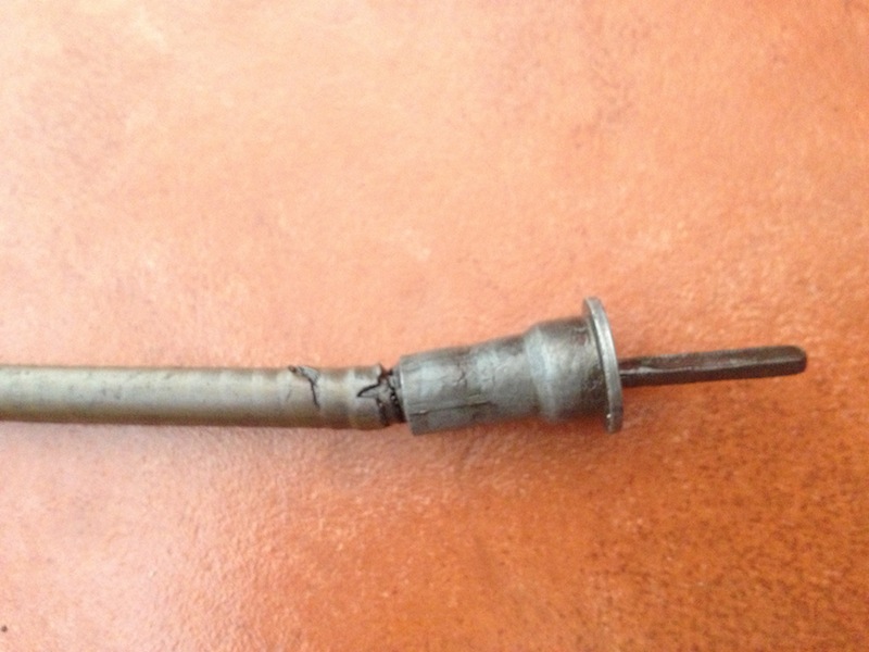

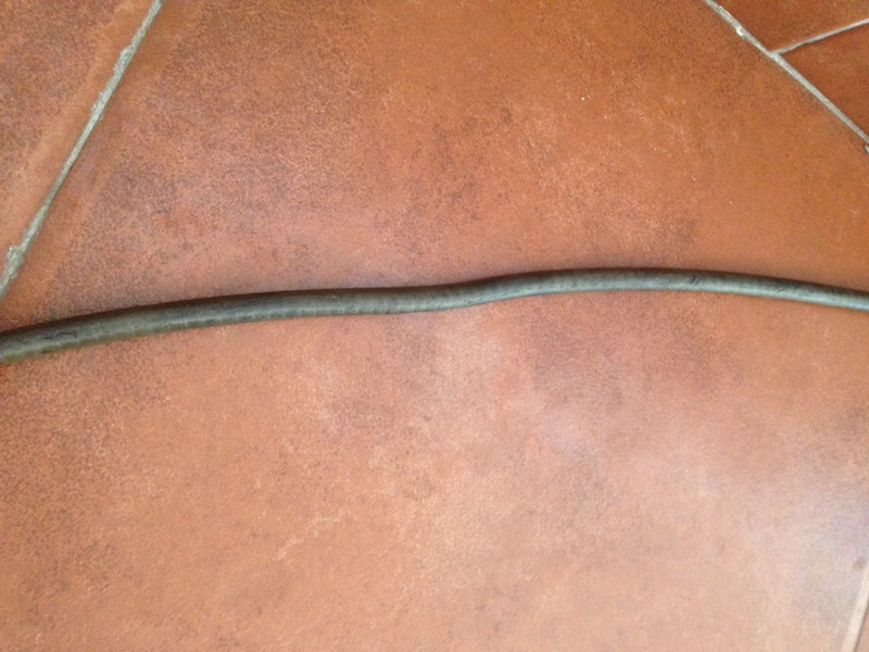

Starting with the simplest my odometer always it has swung much and when pulling out the speeedometer cable I found folded and with a slight resistance to rotation, I straightened it with a pair of pliers and seems that it has improved slightly but asni still believe that the best solution will be to replace it with a new one. Its appearance is this:
Looking at AHspares I see different sizes and I remember some old post which said that some of those who are sold, such as Moss, had to be trimmed. You tell me what reference that offers AHSpares for my model BJ8 is appropriate? They indicate 4.8 ". And other matters related to the odometer. Why exist different odometer for car with overdrive and without OD ? do any mechanical or additional connection in the odometer for OD cars?

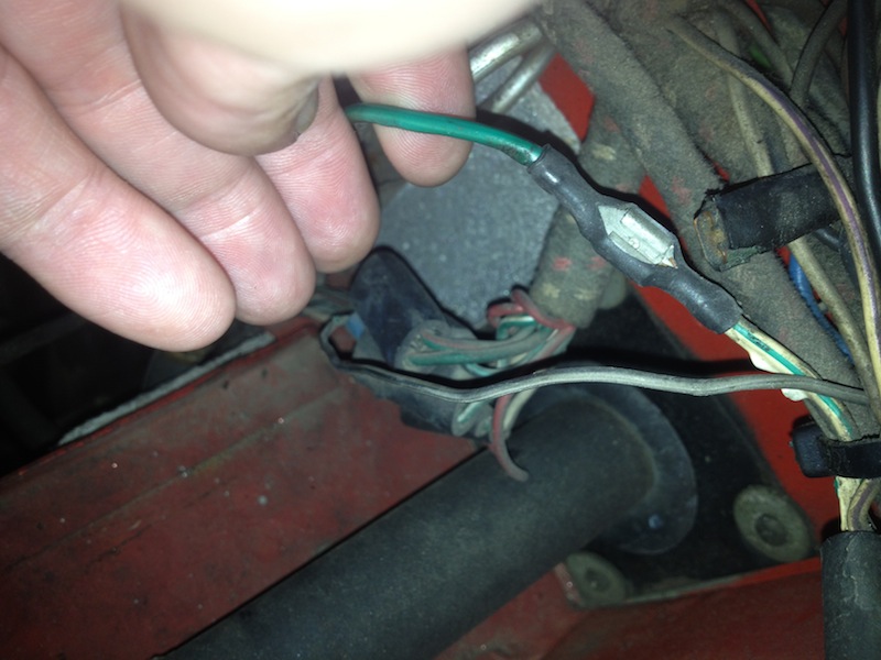

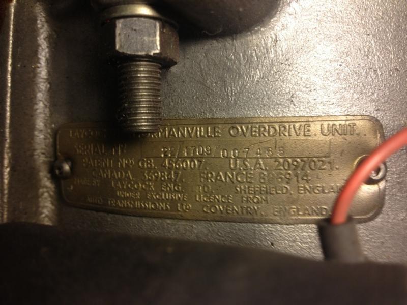

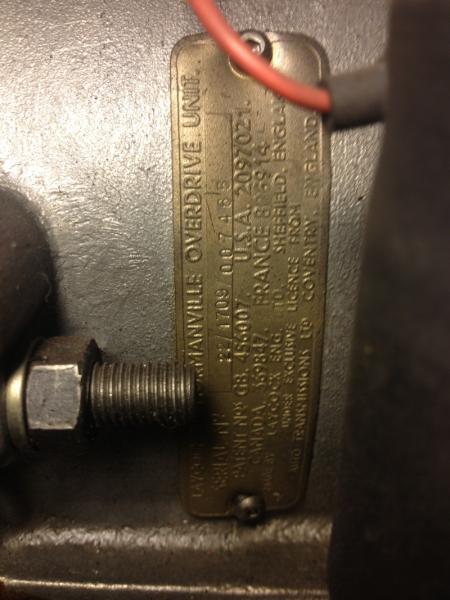

And finally worse not least: my overdrive stops working when I drive over 50 kilometres continued, sometimes already did not work until the next day returned to do so, awhile, when left the car to the idle or played with marches standing. Is a Normanville overdrive, that I don't know if it's the original in this Austin Healey model.

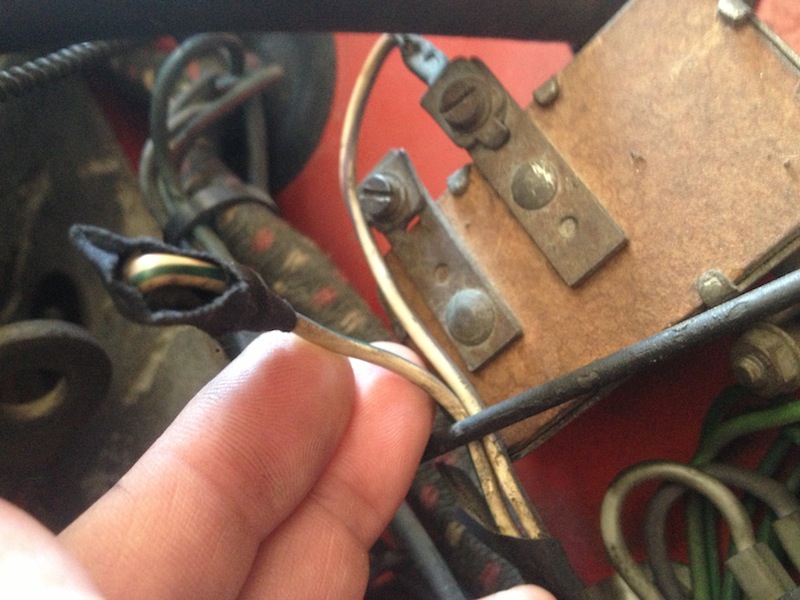

I now suspect that the failure may be due to the gear oil level, but reviewing the wiring I have come to realize that the previous owner or your mechanic had reversed the throttle switch and that in addition the installation cable is bare in a couple of places that would clean up the installation. Is it worth have overdrive throttle switch? How do I check and adjust this switch, do you have a diagram on the wiring color? Right now it is directly connected to the white wire and green, without going through the switch. Now connections are as well, I know scary.

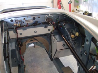

I removed my throttle switch about 15 years ago and never gave it another thought. When I restored the car during the last 5 years, I made many electrical changes. I moved the fuse box to the inside of the passenger area so you will see that many of the wires on the firewall are different because I extended them to suit. See picture. But wire the OD relay exactly as the schmatic shows it But do not hook up the throttle switch. I have 2 rules to operate the OD especially if the OD electrical controls are not in place. ' NEVER PUT THE TRANSMISSION IN REVERSE WITH THE OD ON. ' and ' NEVER SHIFT OUT OF OD WHEN THE ENGINE IS DECELERATING '. But with the last rule if you use the clutch to shift the OD you can do it when decelerating.
I use the oil in the trans/overdrive according to the book specification. I believe that is 30 weight engine oil. Driven this car for many years, OD works great. ..... You probably should buy a new speedometer cable, but if you can get the old one to turn freely it will work. Good Luck, Dave.
