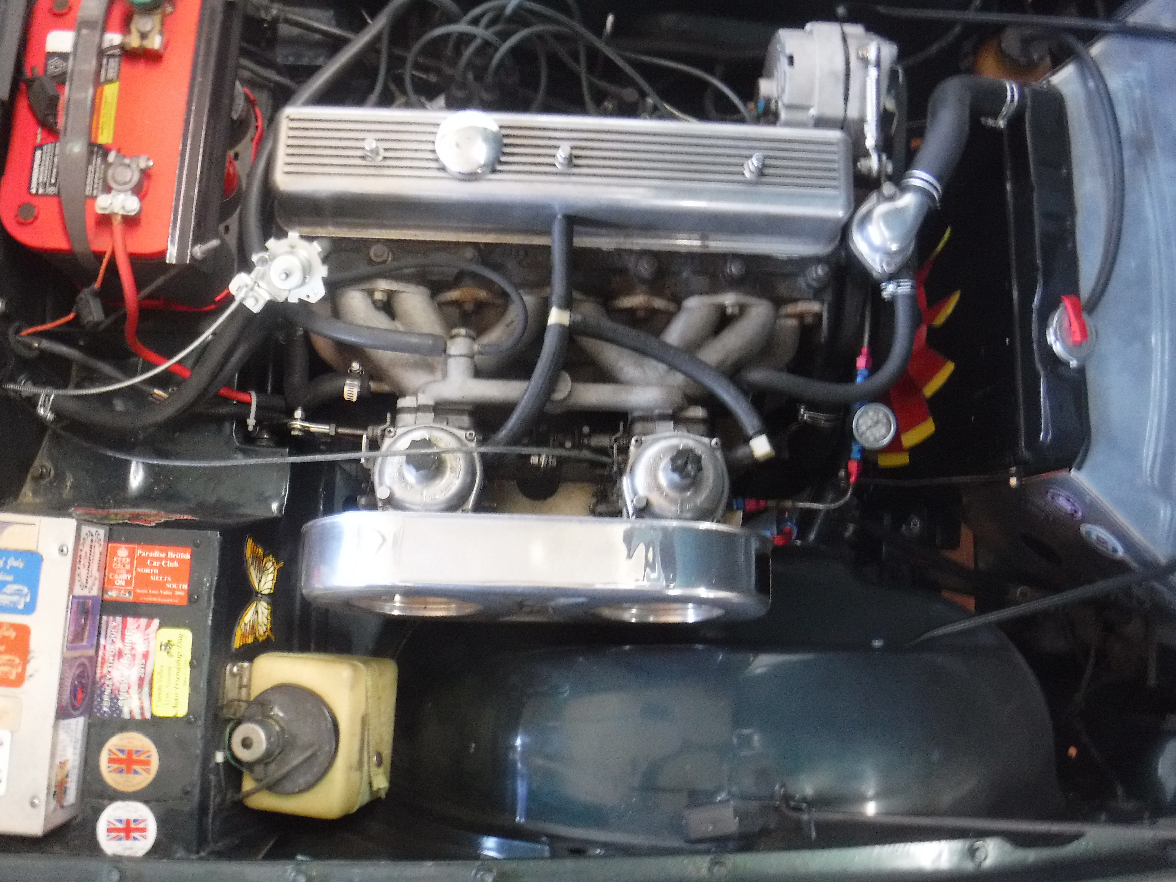

Im going on seven years and 17k with the Wizard and electric fan with no problems.My fan rarely even comes on.With a new motor I wanted a new radiator and the Wizard was the best option for me.
I think at the time Modine made a core but you still needed a good shop to fit it.

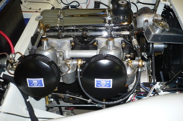

I went for the ali core from TRF it was cheaper even with postage from the USA than getting the old one rebuilt and it never overheats.
Graham
