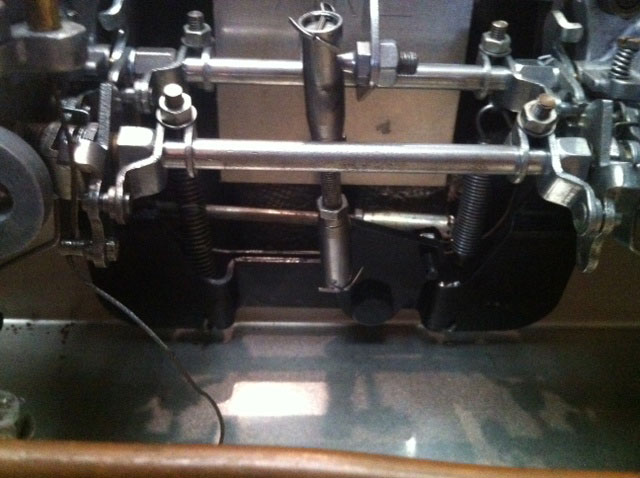

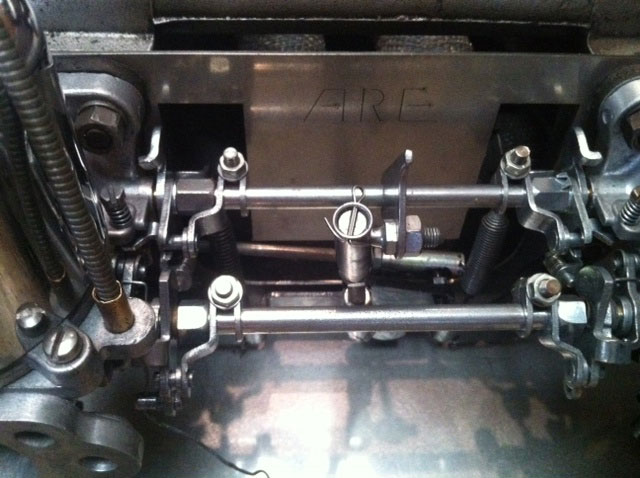

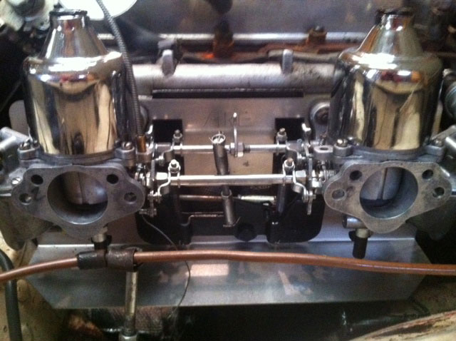

Well, I'm a little new to all of this so any insight would be greatly appreciated. I just got my carbs back from Chester at SUCarbs. Got everything mounted up and I'm having a hard time getting the idle down. Car fires up and races to 3K RPM. I've putzed with every thing I can think of and I'm at a bit of a loss. Help?

Ummm... what engine/car?
Are the return springs all on the right pieces of the linkage?
SU's aren't too hard to deal with once you grasp the concept.
Some photos could help us out, too.

Sorry! I'm sure that would be useful info! Its a 67 TR4A. Before the rebuild, it ran fairly well and idle was around 800 RPM so I dont think its related to anything other than the carbs at this point. (Which is not to say that it doesnt have its share of other problems) Idle adjustment screws are all the way out. I've toyed with the mixture, but dont get any significant change in RPM (although some obviously) The butterflies are shut the whole way at the resting position of the linkage. I've got 20W oil (motorcycle fork oil) in the dashpots. The gas tank was drained and refilled with 93 octane and some ethanol stabilizer additive. New inline fuel filter right before the first carb. Return springs are in place.
I'm just trying to walk through all of the details in case something is significantly relevant.

so if you have unhooked all the linkage, butterflys are closed, are the piston all the way down? the butterflys do have an angle on them since they are not straight up and down when closed, how about the chokes, As I remember when you choke the SU carb the jet drops down to richen the mixture, are the chokes hanging up?

Butterflys have a slight tilt to them. I think the plan for tomorrow is completely disconnect the linkage from the short throw bar. That will remove the long and short bars from the equation. I should have measured them before I shipped them out, but they don't look drastically different. I'm also gonna disconnect the choke cable and take that out of the equation. The jets do drop when the choke is on to slightly richen up the mix. I would believe that the pistons are fully down. I've raised and let them drop a few times on their own and they clunk down.
Anyone have insight as to the effect of having an oil thats too heavy in the dashpot? Its 20W oil, but its fork oil. I'd heard of other using it, but I must say that it feels awful stiff. I over filled initially (that thing takes almost no oil!) and managed to suck a bit of it back out. But putting the little piston back in took a bit of a shove to get down through the oil. The air piston takes quite a bit of a poke to move up now as well. I dont know what kind of oil was in it before as I havent had the car very long, but it seemed a lot lighter and things seemed to move a bit easier. IS there an easier way to get the oil back out or do I need to take the carb off and dump it upside down?

Is that heat shield on correctly ? looks like there might not be a good seal between the carbs and the manifold the way it's installed..sucking air ?
startech47
Do you have 6 gaskets installed?
If you remove the dampeners and lift the air valves. Do they drop freely and click when they hit the bridge?
Platinum
I'd put 20~50W motor oil in the dampers. Wick the fork oil out with paper towels and Q-Tips.
The choke linkage also tweaks the butterfly setting a bit but it appears the screws for the choke cams are well away from the cams in the second pic.
About all that's left are either a leak at the mating surfaces of the carbs-to-manifold or misaligned throttle blades.
Spray some WD-40 around the manifold seals/joints and see if it changes the running. That'd indicate a leak. You could use water in a spray bottle too.

Disconnected the choke cable and the small rod engaging the gas pedal. Took a bit of work to get it started (reaching the key and the the choke assembly at the same time lol) Got a little heat in the motor and it came on around 2100 RPM. fiddled with the idle screws and it'll sit pretty at 900-1000. Its all been on sound today so far. Havent even gotten the sync tool or fiddled with the mixture yet! Soo thrilled! I know I've got a bit to go, but its so much more promising.
I think the throw bars must be a bit out of adjustment and I didnt quite realize just how sensitive they are and the smallest, most imperceptible changes are actually enough to hold the butterfly open just enough.
