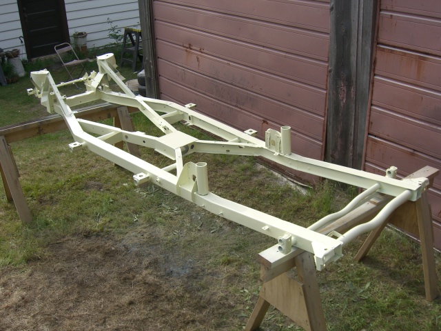

sp53
I guess things are going good with the painting. The paint is a slow drying industrial enamel, so I am taking my time with the drying, but it is supposed to rain tomorrow. The paint came right out from the bucket in kinda small splatters but after I went back off it the paint seems to blend together with a nice looking enamel finish. It does not seem to run and I am able to squirt it into those hard to reach areas. I went with the primrose yellow because that is the way the car came and it should look pretty interesting powder blue with a primrose yellow frame.

sp53
I sand blasted the frame and bought the paint at a commercial shop. They do not due automotive their and were conservative about discussing it. It looked like most of their stuff was for airless applications where they put on gallons a minute or something. i wanted the paint to be a little soft. The auto paint stores around here seem to have sniffed too many paint fumes because every question there needs to make a sale and has multiple answers depending on how much money I have. I got the paint for 45.00 a gallon and the sprayer for 80.00 with two guns and a bunch of toys. I have used the por 15 and found it to be really heavy duty. I was looking for something a little easier to work. When it does comes to doing the body, I will get into that stuff then.

sp53
The car had a roll bar that was welded to the frame and to the side of the shock mount then up through the body. I cut it off and left the two end bottom piece on because off the scaring from welding. They actually used larger pipe on the bottom and stuck a smaller pipe inside and welded that. It was actually a good idea, and I could reuse the base and stick a top section of roll bar back in or just let it go. I eye balled the room and the stubs should not hit the tub and if they do I will them down some more.
