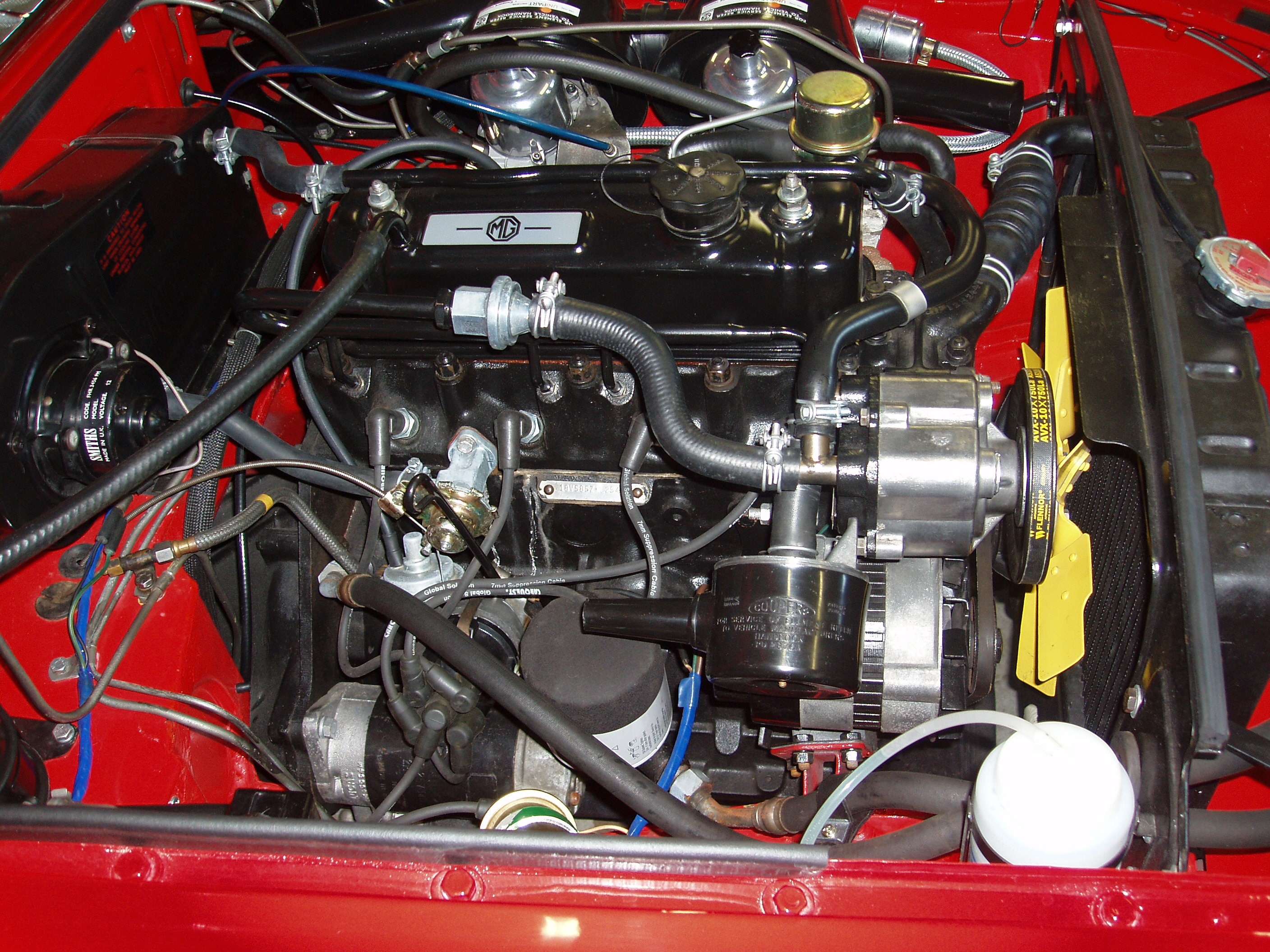

My 72 MGB air pump. PJ

Does the air pump system push air into the intake or exhaust chambers inside the head? I always assumed it was pushing air into the exhaust stream, but I never had the nerve to unplug one of the ports to see what came out....knowing my luck I'd strip the threads and never get it back in.

Pump makes a diluted amount of pollutants come from the tailpipe by introducing forced ambient air into the exhaust ports. It's a vane pump. The blades rust and corrode, then become stuck in their "slides" and seize the pump.
