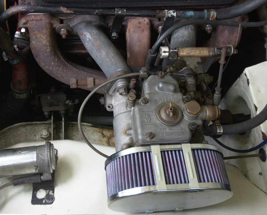

Been running the MG with just the air horns, finally got one of the Red Line K&N knock-offs. Not a lot of clearance at the bottom edge though. Likely will swap it out for the screen style individual covers. Or add another shim under the left motor mount. Don't laugh at the Rube Goldberg throttle linkage arrangement! It's worked for decades.
Platinum
I use the short K&N. It has a single center fastener.
Mum about the linkage.
Yep. The K&N's work on the Elans, but have the same clearance issue on the MG. Just want to keep "the big chunks" from being ingested with the B. As posted, I'll likely go with the individual trumpet covers for that.
That manifold was a home-brew using the spec's for the inlet in the "Special Tuning Manual" back in the mid-seventies when we couldn't get that stuff "over here." I never did make up the braces to the motor mounts, seemed excess to requirement as the street engines it went on weren't pressed into racing conditions.

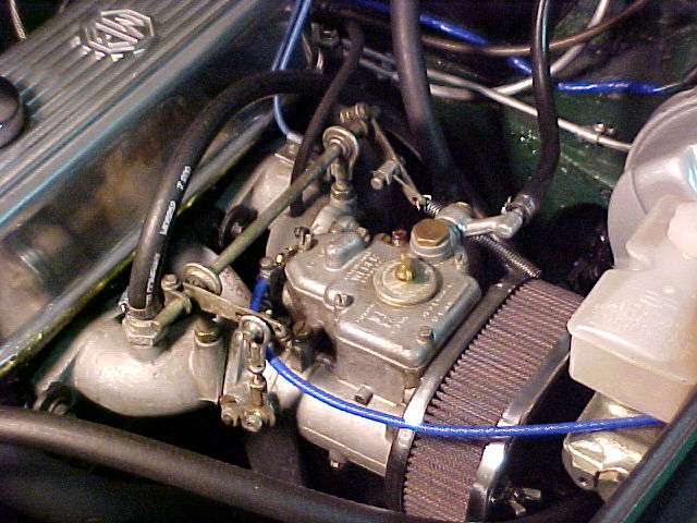

On a '78 with brake booster space is limited. I've used this one from EMPI for years....
With velocity stacks? This is a '65, no extra booster or suchlike. And your intake manifold looks to be a shorter, tighter radius too.
Joe Reed
No velocity stacks, although I've been considering putting stub stacks inside the filter.
Yes, it is the short manifold. the longer one used on the earlier cars won't work on the RB cars with the booster.
Platinum
As I have written before….you do not fit a weber without stacks!
Or really, any side draft carb. SU's have a short, tapered ram effect "horn" built in to the standard air filter canisters. Short bolt-on trumpets are available.
The Zed-S units were post-emission control and have a poor induction system to start with, so intake flow was the least of the engineering concerns. :devilgrin:
Platinum
Do that. Anything to "smooth out" airflow going into the throats helps efficiency.
