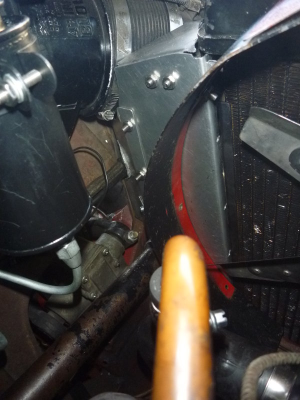

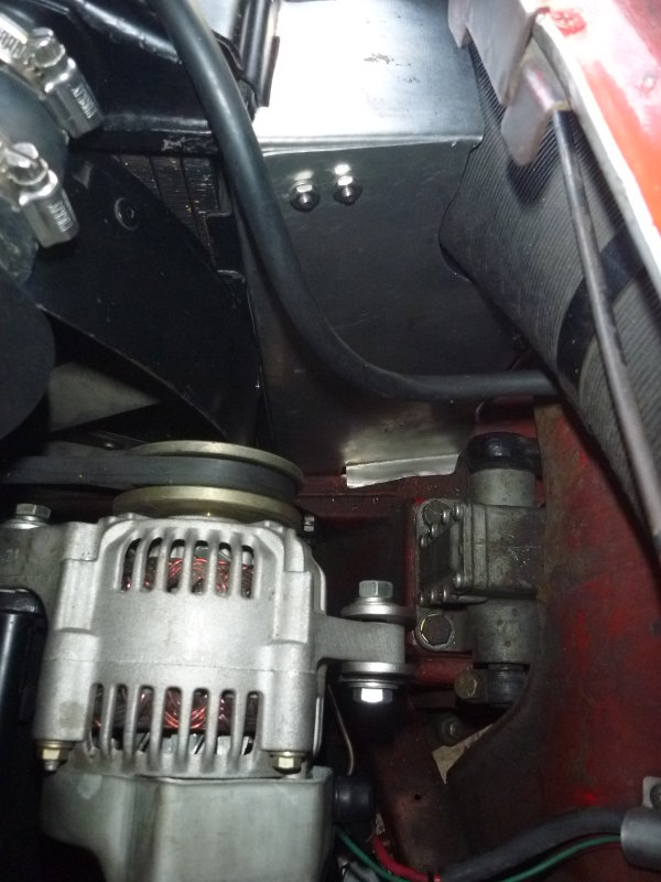

A while back I installed a bilge blower within my Cold Air Duct to bring additional air into the foot well of the cabin. After my initial install of a variable speed control and downward footwell air diverter in front of the cabin vent, an April testing within cool weather seemed to prove the concept. However, testing later showed that the unit was NOT a Success as hot radiator air recirculation was also brought into the foot well when running very slow as in traffic or stopped.
To help eliminate hot radiator recirculation, I created closed ducting between duct and grill as well as radiator and grill to help eliminate hot air draw. Although this effort was more extensive then expected, it did not do resolve the total problem as much of the issue depended upon air flow through the engine compartment.
Not wanting to install hood louvers or fender vents, Dougie indicated some very positive results for improving engine compartment flow from adding (4) 3" sets louvers to each inner fender well. Additionally, I added an on/off polarity switch to the variable speed switch in order to push air out of the Cold Air Duct when going slow or stopped. Although this polarity switch is now manual, it would be nice if I could figure a way to have it automatically and safely switch as sook as the car slows to a stop. Any ideas would be appreciated.
By the way, these additions have improved cooling and at some point this summer hope to change back to my original 4-bladded fan to see how it functions.
Ray(64Baj8P1)

Hi Guys,
I hate to say it but this is the second time I seem to have misplaced Dougies louver-installed pictures. The louvers are composed of two steel sheets of (4) louvers, placed in the inner wheel well reasonably close to the suspension opening with the louver extending out of the engine compartment and down on an angle consistent with the inner fender edge. As Steve indicated, the low pressure created by the wheel well, brakes the air bubble that forms in the engine compartment around the fire wall and draws the air to flow into the wheel well and exhaust area. As I see it, this difference in pressure allows for more effective engine compartment air flow from the radiator and through the engine compartment when the car is moving and also provides an outward exit when the car is stopped.

Ray,
Better sealing would be needed between the grille opening and wheel well in the tie rod area - or the vents would be pulling cool air from the front as well.
Maybe some sort of canvas gaiter could be made that would close off the opening and accommodate the movement of the tie rods.
Blocking the airflow on either side of the radiator would allow the upper suspension openings to function as such an exit.
