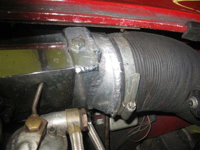

My 100M has higher HP and compression than standard. I am filtering the air intake with Denis Welch's adapter and ITG filter, but I find that the filter restricts the air flow too much. Any recommendations for a better flow through filter would be greatly appreciated.

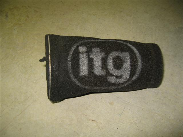

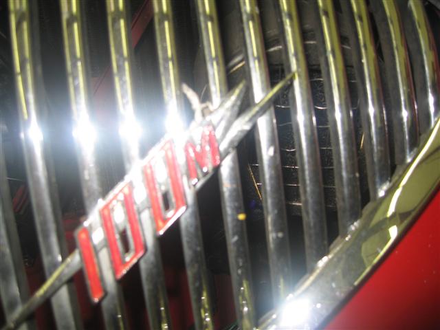

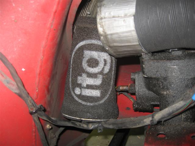

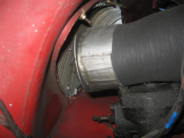

Here are five photos showing the cold air box to hose adaptor and the filter which I have mounted at the front end of the hose. As you can see it is removable through the wheel well simply by pulling it out and it looks to be the same one pictured on the DW site. This photo shows it behind the grill--just to the right of the flash.

#3
Michael Oritt
#4
Michael Oritt
#5

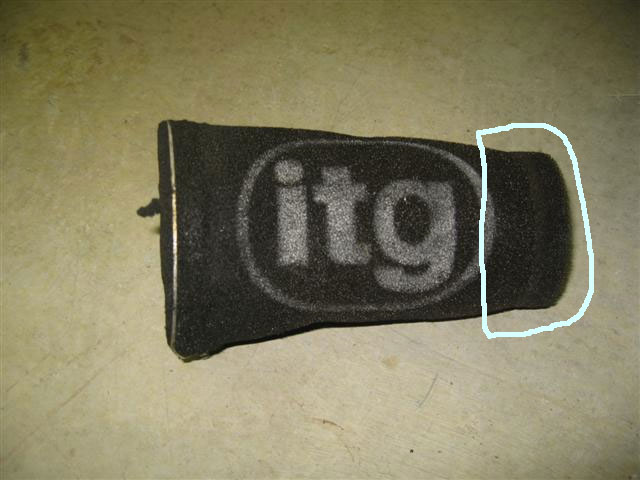

GregW
Platinum
Hi Michael,
Are you using that filter as Denis Welsh had intended? Seems like it is installed backwards. In essence, your only using what I've outlined in the below photo. Since the filter causes resistance to the airflow, you might be starving the engine of air.
Michael Oritt
Hi Greg--
Yes, the cone is installed backwards as I am using it at the bottom (front end) of the hose rather than the top by the CAB. But the filter is normally inserted all the way in the hose as shown in picture #3 and I can't see how that would restrict airflow, though I am always willing to be enlightened. I have no signs of starvation, at least that I know of.
