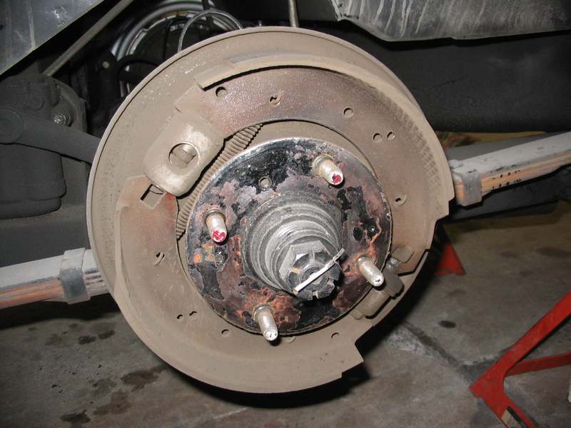

If you're writing about the adjuster in the rear brake slave cylinder, the adjuster is made of steel in the aluminium casting for the main body. There are 4 flats on the hidden inside end of the adjuster and if the adjuster is half way between flats, it will lock the lining onto the drum. Maybe all you need is to get it loose as above and give it 1/8 of a turn to get it back on the flat, instead of the corner where it binds.

I like Don's suggestion above. It's not uncommon for those two pistons to become quite fixed in their position, and that will make the adjusting screw seem to lock when you turn the screw past the last easy flat. You will want first to concentrate on backing the adjusting screw off, then attack the two pistons. Usually a screw driver blade between the two will give enough leverage to break them loose.
