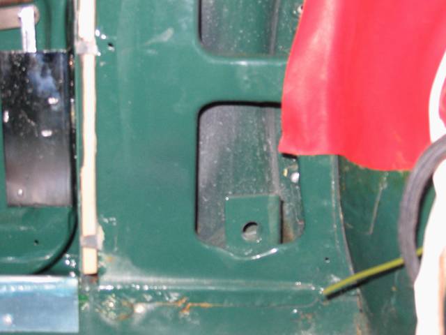

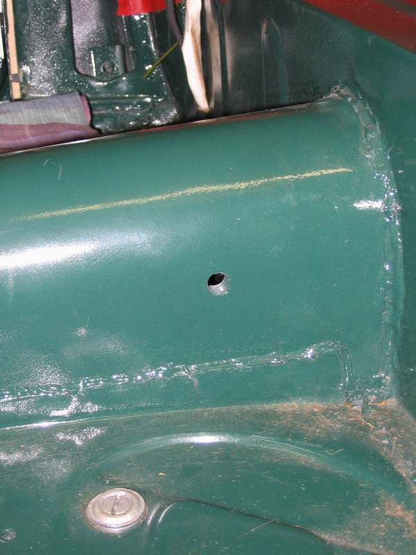

Working on body fittings this weekend. Frankly I'm tired of the Chassis. Does anyone have a good picture of what and where the seat belt mounting plates and mounting fixtures go on the 3A. I have the stuff but just not sure where it goes.
Thanks, Tinkerman
Don Elliott
I have 2-point lap belts and I secured mine on the sides with an angle iron and nut welded into the rear quarter panel while I was doing my restoration.
For the center, I drilled a hole on each side of the rear tunnel and welded in a 2" by 2" steel plate curved underneath with a nut welded to these plates. The photo shows where I did it on the BRG TR3A I finished in 2006.

Righto Don, thats exactly where yu holes are, or close enough, anyway. Apparently mine came from the factory with seat belts.
Thanks a bunch for the pictures!
