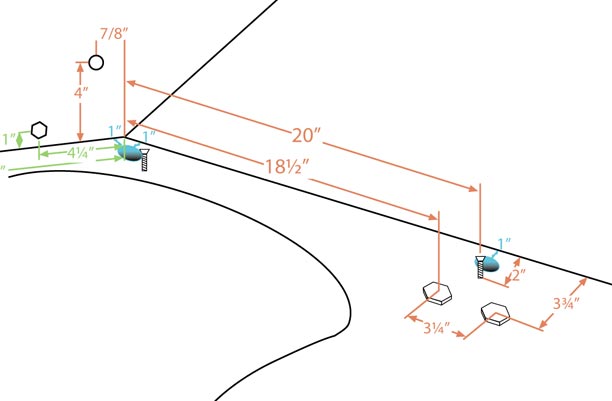

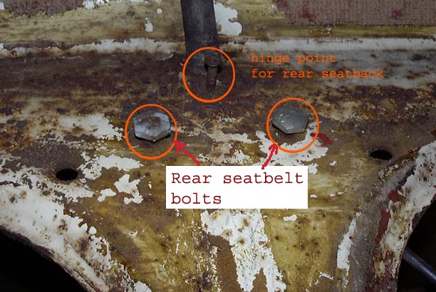

GregW
Platinum
Hi John,
For the rear seatbelts, I only have the location for the center two mounts. For some reason, none of my restoration photos even have a rusty hole where I'd think the outer bolts would be. If you look at the seat surround from under the car, you may still have some welded nuts that the seatbelt bolts thread into.
