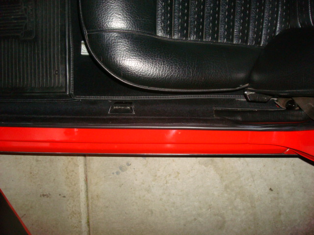

Currently my '73 TR6 does not have seat belt parkers but I am looking at picking up a pair.
Since they were not on the car when I got it, I have no idea where they mount. Any photos of the correct mounting position would be appreciated... thanks everyone!

Don't think it was exact science where they were put, just get it close. If you did not replace the inner sill the original holes should be there. With mine you could tell they just used a punch to mark or drill the holes. Each hole was dented in some. With mine if you measure back 3" from the front of the seat track to the center of the screw in the front mounting tab you should be in the right place.

Keith- Thanks! Your photo and description help alot. Honestly, I had no idea where they were mounted. Thanks for the help.
