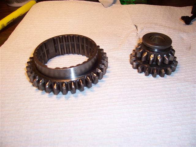

Had a chance to open and inspect.
Found as advertised, reverse and first gear kind of sad also the peice the mainshaft bearing fits into. Not listed in moss. No reason it should be damaged except that it looks like the guy who took the tranny apart used a punch on it.
All damage on the tranny was caused by people. Crunch into reverse and first. Sigh.
Even the synchro rings are in good shape. I find no wear otherwise on anything, excellent tranny.
Anyone got a reverse gear for a rib case that is useable? On third thought I think all else is just fine. I keep going out into the garage and reinspecting. Hehe.

If anything the tranny is in better shape than you suggested.
What was the reason for the disassembly? I find nothing wrong except a reverse gear and they sure are not a deal.
I can find no missing teath, reverse is well worn from crunching, first actually looks preaty good.

Here is a pic of the two that are worn. Only these it seems.
Any comments?
