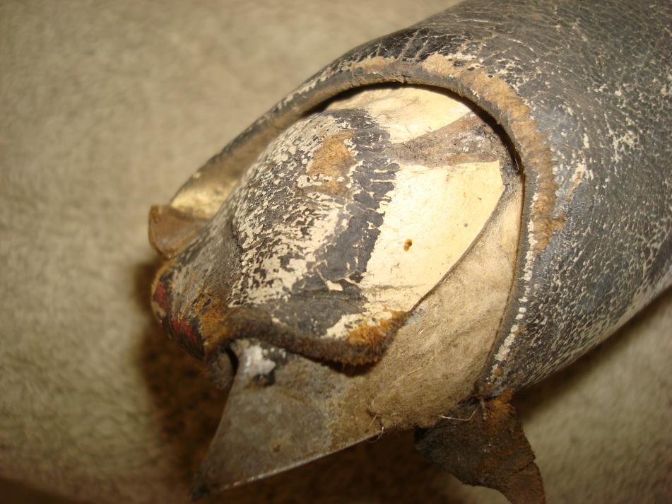

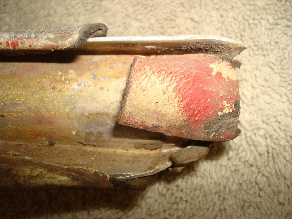

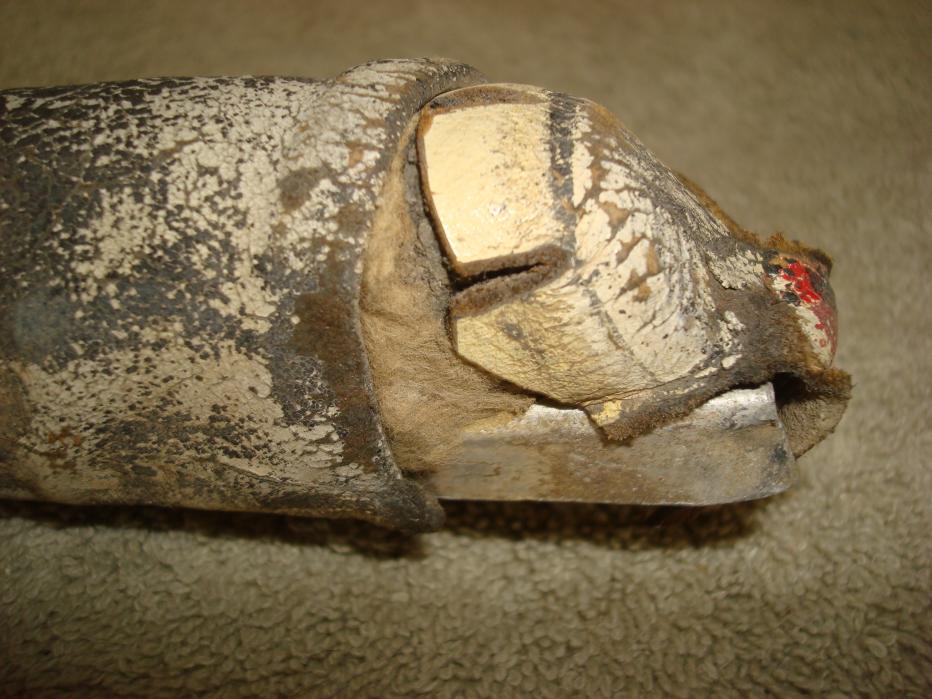

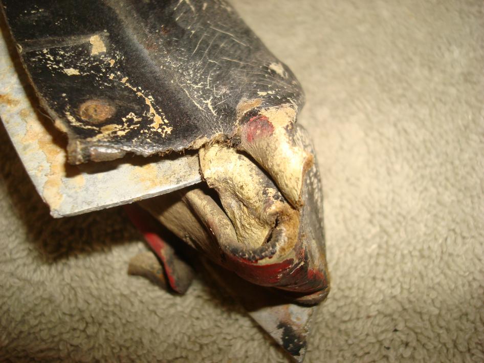

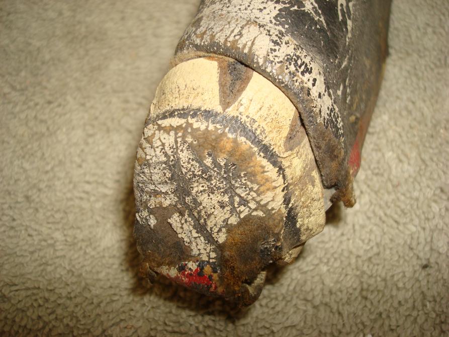

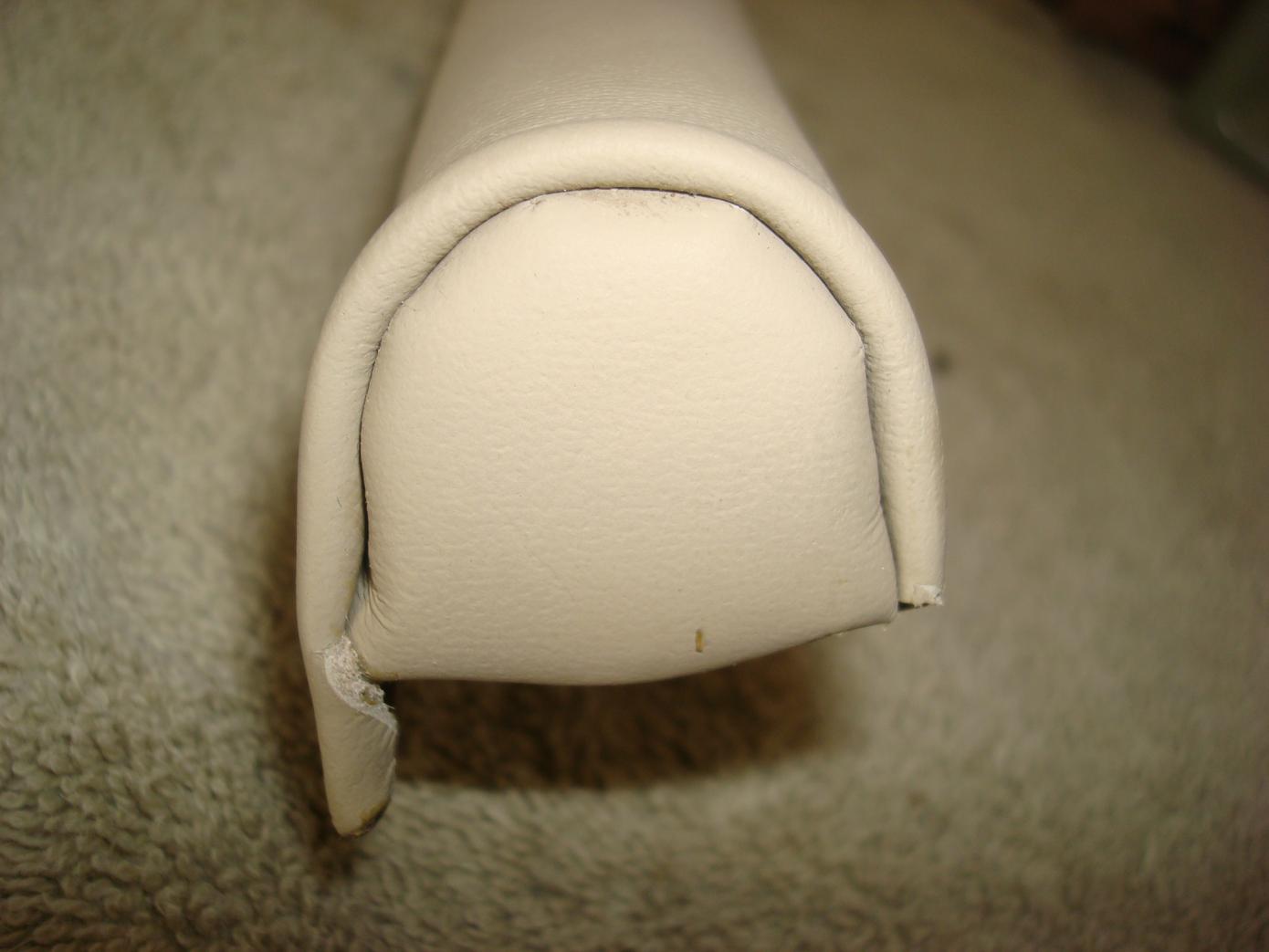

Does anyone have a guide on recovering the elbow rails? This is for an early car where the vinyl/leather is just folded over the end of the rubber cushion, not a later car with the chrome finisher button. How the folding is done is what I'm interested in.
Unfortunately, I managed to lose the originals from TS13571L, and all I have are the base pieces from another TR3.

Here are some shots of an old capping I have in leather. The leather has shrunk up quite a lot showing how the cap was made. Kind of ugly pictures but they mat help. The one picture is how my new one turned out.
mallard
More pictures

Thanks, Keith. That does help.
