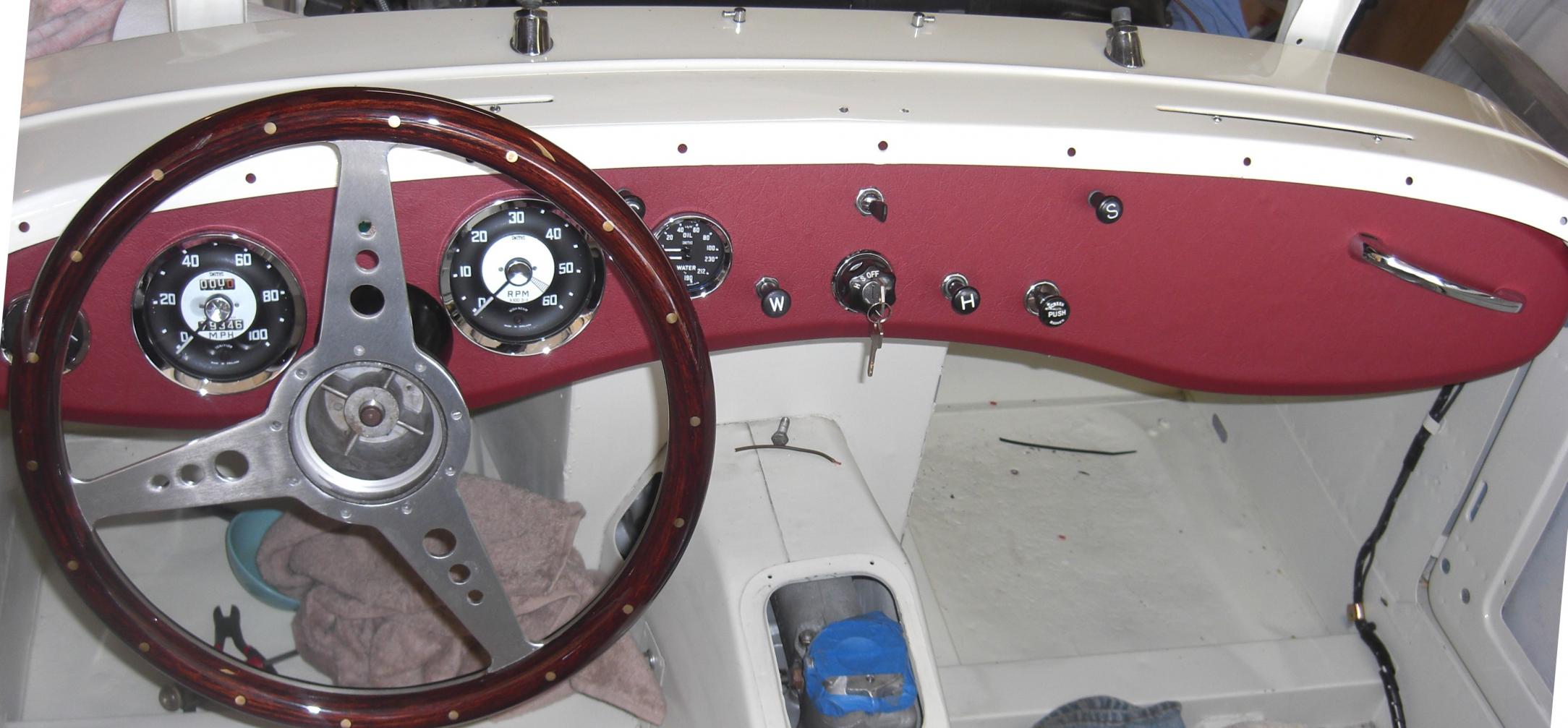

I recovered my dash and panels last year. I stripped of the old vinyl, cleaned up the metal front and back, and renewed it using burgundy vinyl and 1/4" foam purchased from a local fabric shop. The end result is very nice, even if I have to say so myself! /ubbthreads/images/graemlins/tongue.gif I like the "padded" look, but the purists would tell you the originals weren't padded.
