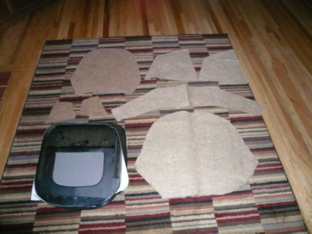

Here is a pic of the padding stuff that came with the Moss kit. The cushion is in the seat bottom, but I don't see how to attach it at the seat pan on the flat part. There are some little tabs that look like they can be bent out to puncture the cover and hold it. In the pic, its the lowest part of the image. The rest clips can hold it.
As for the padding, someone help me out with where this stuff goes. I don't have the original seats to go off of. The kit says its for the bugeye, so it should be correct. The top left is clearly the seat back, with a fatter area on the bottom. The rest, I don't know. Input anyone?

histerical
Those good photos should show where all the clips go, except for the lower seat back ears. These are slipped on and secured with some small points in the metal, and the cover's just rolled back under itself to the piping.The heavy jute-like stuff goes on first, and can be tacked on with some spray adhesive, then the padding goes on top of that, and can also be tacked so it doesn't shift.. It helps to slip a light plastic bag over the back to help putting cover on.
The hardest part I did was compressing the foam to attach the bottom cover. It is really stiff , but will soften up with some work. Put it on the floor and jump on it ? I think I used some clamps on it upside down.
The bottom panels keep the mice out mainly, I guess. if you don't get some real ones, hardware cloth would probably be fine, and you can also just pop rivet whatever you use. Then again, the solid ones ,tack welded, might give the seat some rigidity, though.
