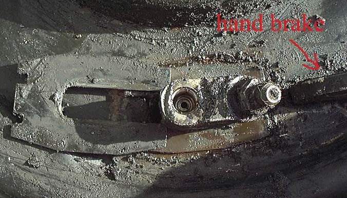

Here's a photo of how mine came apart. Can't say for sure this is correct, but it works.

Gregg
I love the picture.
I do not seem to be able to get the bottom one on as the hand brake lever is in the way. That is where I get stuck at.
I power coated my backing plate and I think the hole that the wheel cyl goes through is now too tight. All I can think is that maybe I need to cut out the coating in that hole and the cyl will slide better???
Plus it looks like both your clips are facing the same way. I am trying to put mine in from different directions? Maybe I am wrong. ????

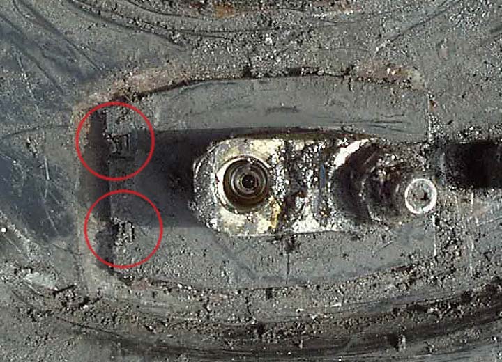

Ummmmmmmmmm, I can't remember the orientation. There are two tangs that face up on the bottom clip. These interlock with the top piece as shown in this new photo.
