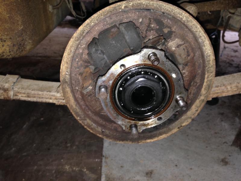

Once you get the wheel off you'll see the screw, its between the wheel studs. Once you get the screw out the axle can be pulled out by hand. The pic above shows the axle shaft already removed, notice the big nut. You need to take that off to get the hub off and the bearings and seal out. I use a big cresent wrench and punch one of the studs out so I can get the wrench on it., make sure to put a nut back on it before you try to beat the stud out. My old bearings were tighter than the new ones so I resued. IIRC its a 207 which is a very common bearing. A local industrial supply had them for $6.
