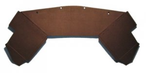

I need help. I am trying to install the radiator shroud - my TR6 didn't have one when I bought the car, so I don't have an example to go by. Does anyone have detailed pictures of this, especially on the sides or know where I can get one?
Thanks, Kevin
Musicman
What material is your shroud made of? Is it the original fiberboard type material? If so, you'll have to bend it into shape. There are diagrams of this in the VB and Moss catelogs. If your shroud is made of either PVC or aluminum/stainless steel, it may be harder for you to fit it in.

I have the fiberboard type of material. I already looked in the VB and Moss catalogs. I have a manual, and it did not have a picture of it fitted in the car either. I took pictures of TR6's at a local car show over the summer before I bought mine, but failed to get the shroud area. If I had a picture of a side profile of the engine compartment I would know what to do.
