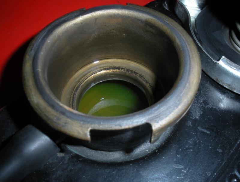

One more question...Does the radiator cap provide a good enough seal without any modification?
There needs to be a seal between the cap and top of the neck. The standard cap seals at the bottom of the neck only, and there is a springy metal disk at the top that doesn't provide a vacuum seal. You will need put a rubber seal between the springy metal disk and the top of the radiator neck. Caps for modern cars have these, but the radiator neck height is different on a Healey.
steveg
Nevets - I originally had a plastic tank somewhat similar to yours. It had a thin rubber seal inside the cap, which I cut a hole in the center of and used as the seal as John describes above. The seal was no longer necessary in the plastic tank as it was open to the atmosphere anyway.

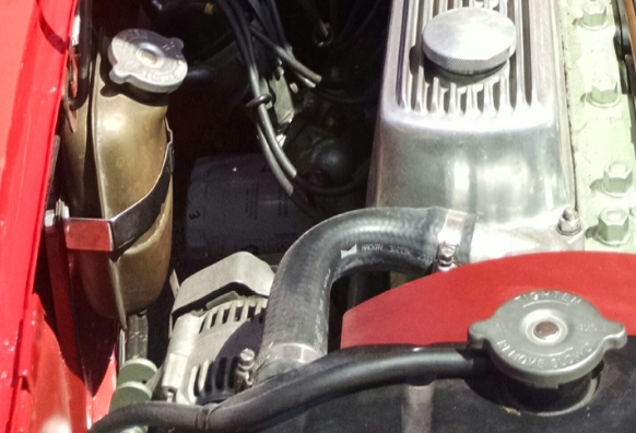

My setup was originally identical to Nevets' above with a square tank in that position and it worked perfectly.
I kept enough coolant in the bottom of the reservoir to cover the outlet and kept the radiator full to the brim. It would stabilize with the coolant about 1/2" down from the filler neck. It would pull the overflow back when the radiator cooled.
Now I'm using an MG brass tank clamped to the shroud support. It works equally well.

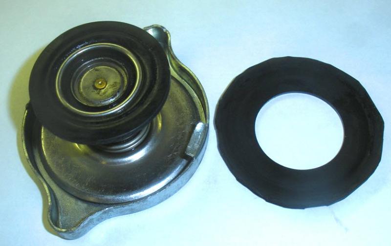

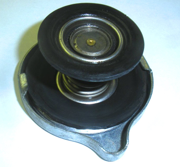

steveg
This is the cap I purchased from NAPA. Not sure if it's 7031411, but it does have an upper rubber seal, as well as a spring loaded lower seal. Hopefully this will maintain a vacuum without an additional seal?
That'll work fine as long as the depth is correct. This 1/16" rubber gasket's been working well for >10 years on the stock cap.
nevets
nevets
Steveg, thanks for the pictures. If the NAPA cap doesn't hold a seal, I'll add a gasket similar to yours.

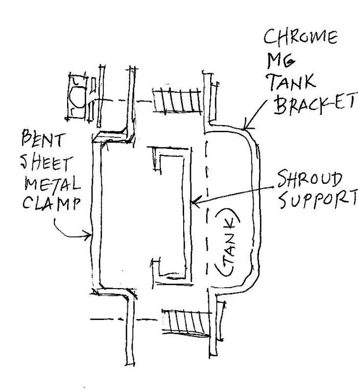

dcarlg
Steve G. and Randy F. both have the brass MG overflow tanks.
Anyone else?
How exactly did you mount it to the shroud support?
I have the tank and the bracket that came with it.
Thanks.
Douglas
