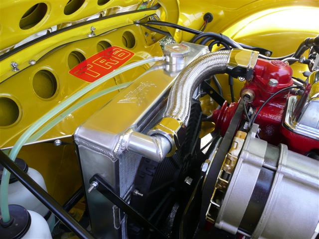

Cool, but where's the picture?
Brosky
Here's a picture.........

That what im talkin' bout GO PAUL!!!!
You Too Bob D.
I could only dream.......
Brosky
Why? What's the matter with yours, Bill?
I think that it looks really good with the black wrinkle finish look.
kodanja
its ok but far from spectacular

Dang, Paul, you can see the reflection of that overflow hose. Shiny!
Looks great!
