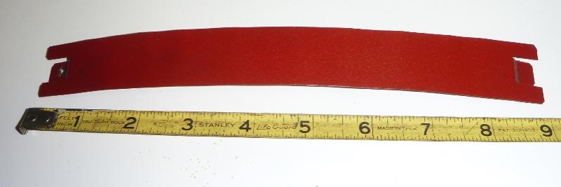

steveg
They go under the shroud at the top and attach to the upper of the two lower radiator mounting bolts on either side. They're pretty floppy this way unless you fasten them to the upper shroud. I made a hidden strut out of sheet metal that presses them apart and holds them tight against the underside of the upper shroud:
