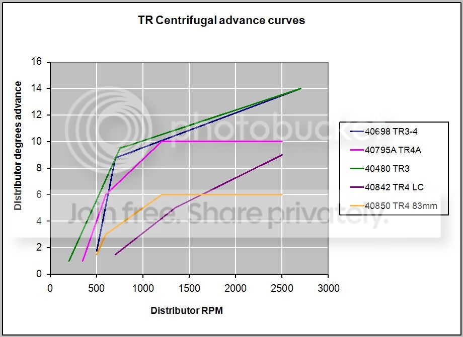

It needed to be timed correctly which I did with a timing light. I twisted the distributor until I got the knob adjustment where it should be. I used an advance curve posted here and set 1,000rpm at about and inch advanced (8-10 degrees before TDC I'm guessing) on the pulley. I then retarded it enough so that it would start. I checked to make sure that it advanced beyond the 1,000rpm. I haven't check pinging at high speed since he doesn't have insurance or a current tag for the car which never ran right since he got it.

Also, please note that the above graph was not intended to be an exhaustive survey. There were several other distributors used on both TR3/A and TR4/A. I did the curves just for comparison between some of the more common ones. (The 5 digit numbers in the legend are the Lucas model numbers for the graphed distributor.)
8 degrees is only about 3/8" as I recall.
