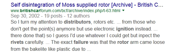

These riveted-rotor failures have been widely known for years:

Now how n the world could it come loose when it was riveted ?
Maybe:
After a severe electrical breakdown the plastic could have been pulverized releasing the rivet.
