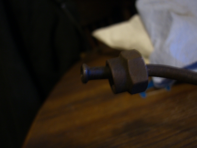

Thank you 6TTR3A fro you response. To answer my own silly question for the possible benefit of others, the solid line going to the gauge looks to be a 3/16th copper and it has a double flare with a captive nut that attaches to the flex line come off the oil filter unit. I finally found a combination of odd fittings in my collection that would not leak.

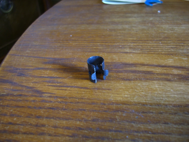

I found an extra one I have and took a picture. If you do not have that line, I would love to trade it for some of those clips that hold the rear fuel line from the gas tank to the body tub. I tried to trade one of kids for those clips but could not find any takers, but tr3 parts are special. However, I think you can purchase the line from the Big 3—maybe.

Well that would be fantastic. The clips are at the rear of the tub and fasten the back section of the fuel line to the tub.

CJD
There’s one on the front wing too, which directs the radiator overflow tube...

No worries I would have felt guilty if you did not have enough for yourself too. Those clips are very difficult to find. I have never seen any for sale anywhere. Plus there are a lot of substitutes that can be used. A tr4 has something that can be made to work and can be purchased at Moss.
