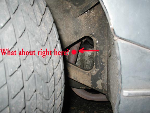

What about going in through the wheel well?

I think that spot is probably good enough, except I would place it sticking backwards out of the pipe, so you can turn it with a wrench through the hole. It's usually difficult to use a socket on a sensor because they have the long wires attached.
We've been working with O2 sensors for our test engine and found that placement is critical if the gases are not mixed thoroughly. Also, too fast air flow over the sensor pushes the calibration out a bit. We have to have a shield to reduce the direct airflow. The sensor needs to be at a high temperature, and with cooling of the exhaust pipe placing the sensor further downstream requires insulation wrapping of the pipe to retain the heat.
