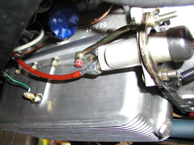

Here is a picture of the sensor installed in the alloy pan.
It really wasn't too interesting, about all I learned was that the oil takes a lot longer to get up to temperature than the coolant.

OK, in that case, I don't think an oil temp gauge will do what you want. Based on mine, it is very slow to indicate any changes.
Another option might be to find a place in the water jacket to install another temp sensor. Like the maybe the block drain tap hole? That should hold water longer, and perhaps show a temp rise.
