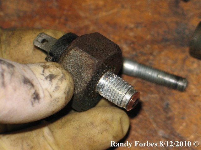

Hi, I'm new to the forum and hoping for a little help from some of you gurus. I am helping a friend with his 1969 Austin Healey Sprite. His brake lights have stopped working recently (all the other lights work fine and all fuses are good). In checking the brake light switch, I found no current going to either side of the switch. In further examining the switch, I see that there is a jumper between the two terminals and the only continuity is between the bottom of the plunger and the two terminals when the master cylinder is pushed in by the brake pedal. This to me would indicate a ground is produced instead of the normal switch that supplies voltage to the other terminal. However, the lights seem to be grounded by the housing and housing screws. The brake lights are on the same bulb as the tail lights and I assume it is an 1157 bulb. No current gets to the brake light wire when the brakes are pushed.

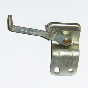

the presence of a jumper on brake switch IMG_2457.sized.jpgcan indicate that on the car is applied a mechanical switchStop_Lamp_Switch_-_Lucas_31638.jpg or one electrical switchbrake-switch04.jpg nearest the brake pedal, but I don't know the Sprite electrical wiring diagram

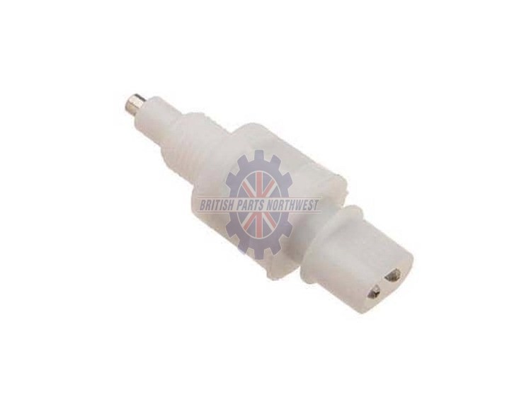

These are images of the switch I found on the net. It screws into the side of the master cylinder, not under the dash on the brake pedal. I supplied current to both wires that connect to the switch, but still no brake lights. That's why I think the current must go thru some other module before it gets to the lights, maybe something separating the signal from the turn signals or emergency flashers. I can't find anything about it in the service manual.

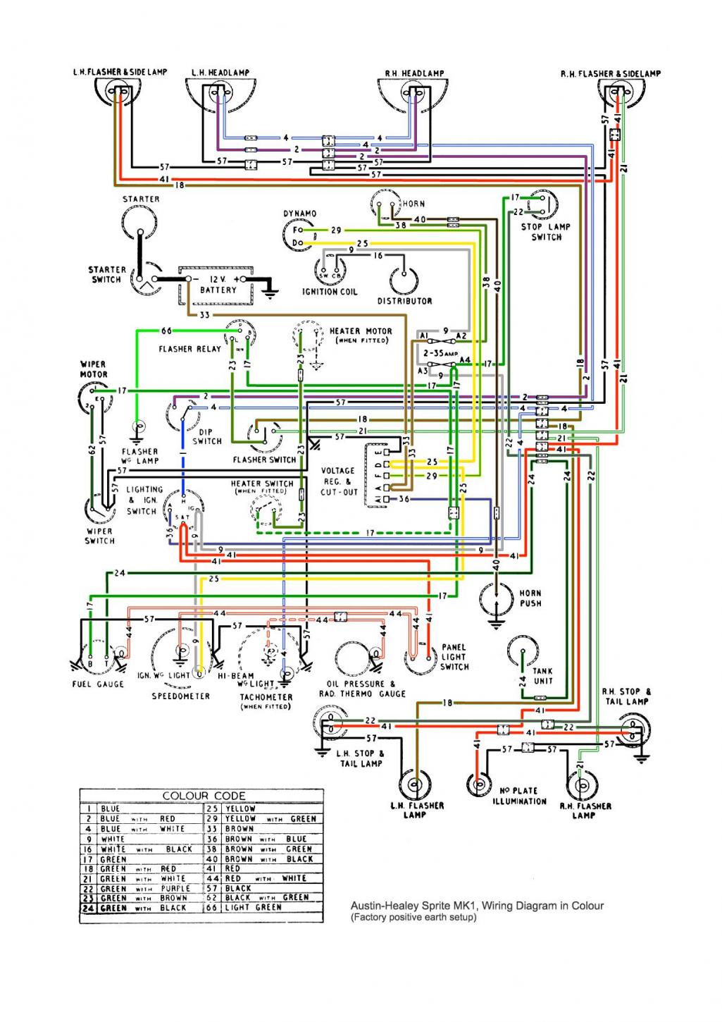

diagramwiring-2.jpgI suppose that your friend have a Mk1 Sprite, on this diagram BK SW are number 18Dwirediagr2-001.jpgon this base you must control the 12V at A3-A4 fuse an the GREEN wire from here to the BK SW !8 --then the GREEN PURPLE wire go to the rear lights- car have Positive ground at origin
you can use a tester or better a lamp test to control the continuity of the wires involved
