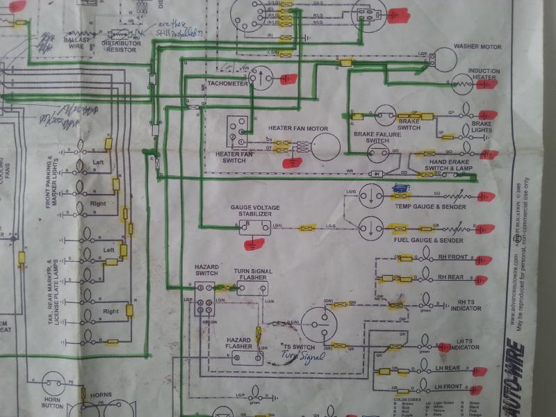

Just bought a 79 "B". The lights were all working on the 2 test drives and now nothing. No turn signals, reverse or brake lights. All are on the same circuit but the fuse is not blown... Any ideas why I got nothing?

If any of these are getting power then its a lose bullet connection or lose ground. Rear common ground is indeed in the boot in front of the license platej
WillR
Advanceauto-wire.com has some great schematics. Welcome to the forum and keep us posted
Bet you can't tell I had the same problem... green is everything that fuse powers. I ended up taking the fuse box out and soldering the conections on it. Good luck!

Thank to all. Still no resolution, but I will update (not enough MGB time!). Good to know about the ground. Bridged the fuse circuit and didn't work. Nonetheless, I am going to replace the fuse block for good measure. Should I replace the ignition relay?
