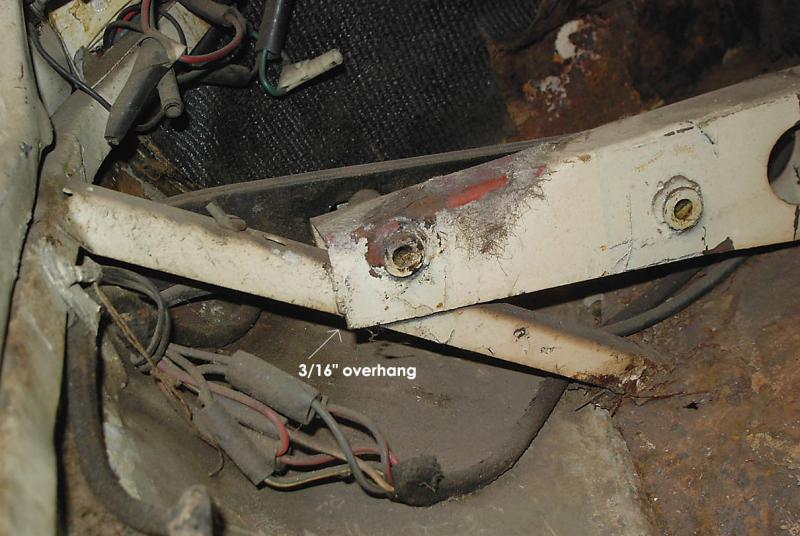

Check the wire connectors in this area. Left side trunk, green/purple wires at their connectors is my guess.
