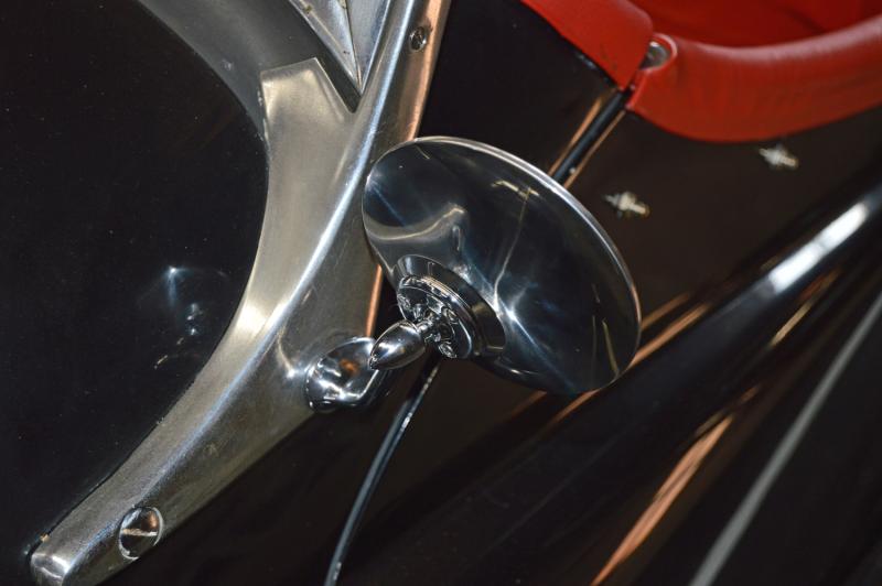

Hello......I purchased the HD mirrors on ebay....item captioned Harley Davidson universal 4 inch chrome mirror....you need both left and right because the stem is angled for each side. Cost about $20 each. They are mounted in the screw holes of the windshield. Hopefully the attached photo will be there for illustration!

Might be worth mentioning that this trick only works for later cars, with bolts holding the stanchions to the scuttle. Won't work so well on earlier cars (like mine) that use Dzus buttons in that location.

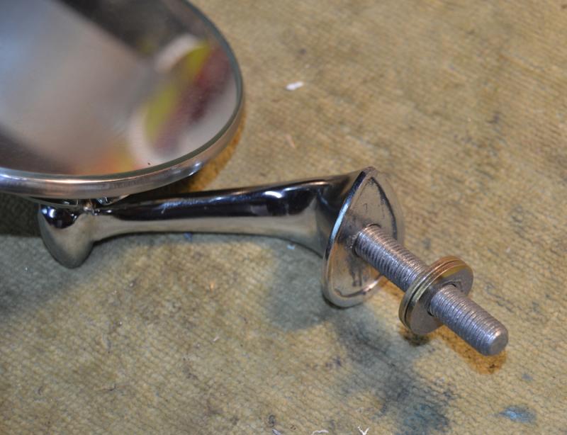

I have convex wing mirrors on both sides. That helps. But, I also added a mirror screwed into the stanchion where the rear bolt goes. I used a convex wing mirror from the right side, and modified the length of the stud. The original stud is the correct size (5/16"-24 IIRC), but too short. Since it was part of the casting, I just cut it off, drilled and tapped a hole and screwed in a longer stud. With a couple of flat washers for spacers, the mirror just screws right on in place to the stanchion screw.
Edit: I tried using a clamp-on mirror on that strip. It lasted about 6 miles before it fell off and the car behind me ran over it! :sick: And, yes it will interfere with the side curtains.

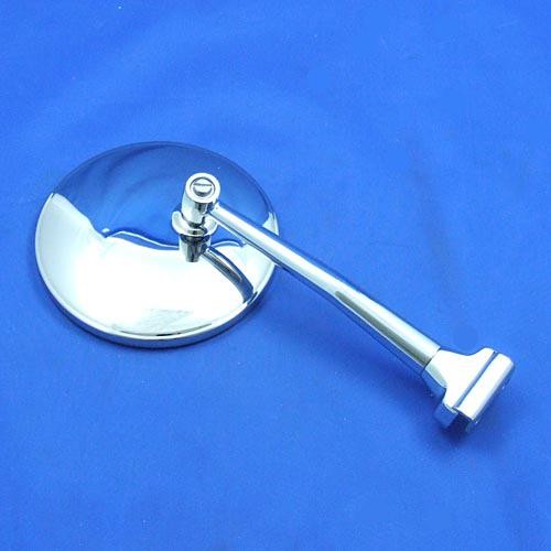

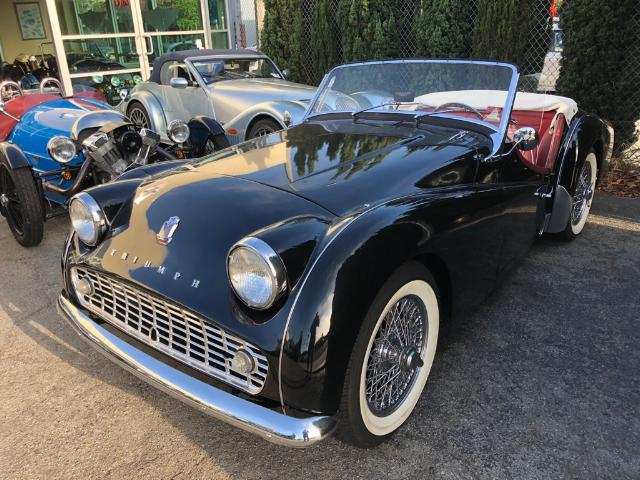

I didn't like the wing mirrors, they were "too far away" to see properly. I did add a clamp-on mirror bought from Vintage Car Parts in England at: https://www.vintagecarparts.co.uk/categories/vintage-car-parts-accessories-mirror-exterior
It's stayed on so far, using set screws to clamp the windshield side tenon (it does vibrate, though). I have not tried the side curtains yet. Attached is a picture of the mirror and on my car. A better mirror is in the other photo of the TR2, but that would require drilling/tapping into the Dzus or bolting through the stanchion mount.

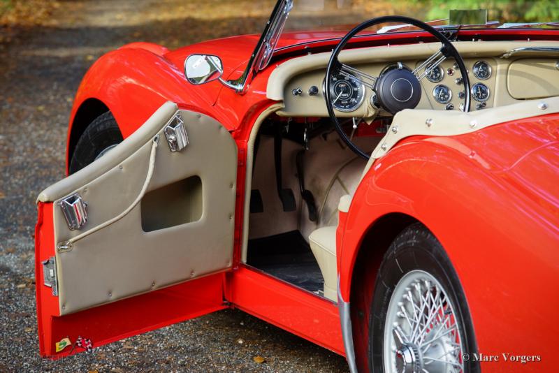

Graham H

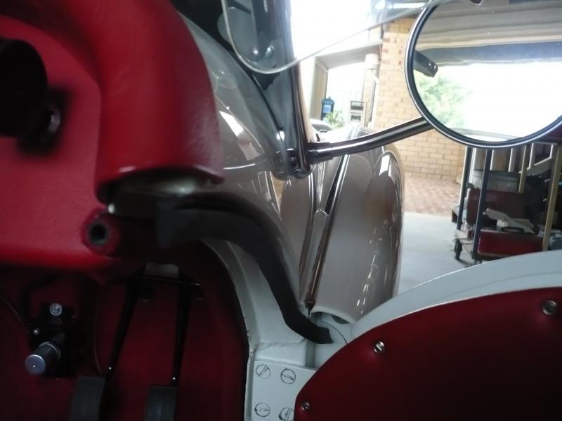

Hello David,
The side mirrors are still available from the tr-register.com.au look in the for sale section,
as you can see fitted to my car I can't remember how much I paid but they fit well and don't get in the way of the side screen
