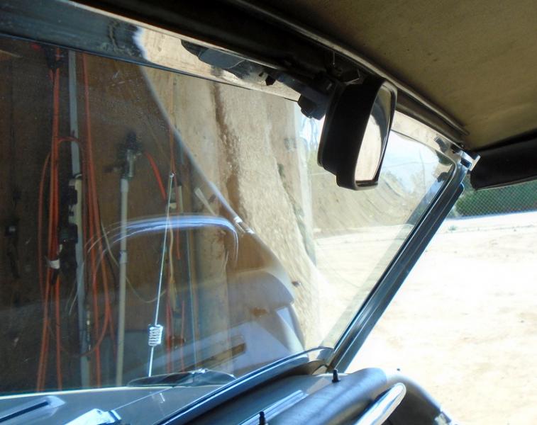

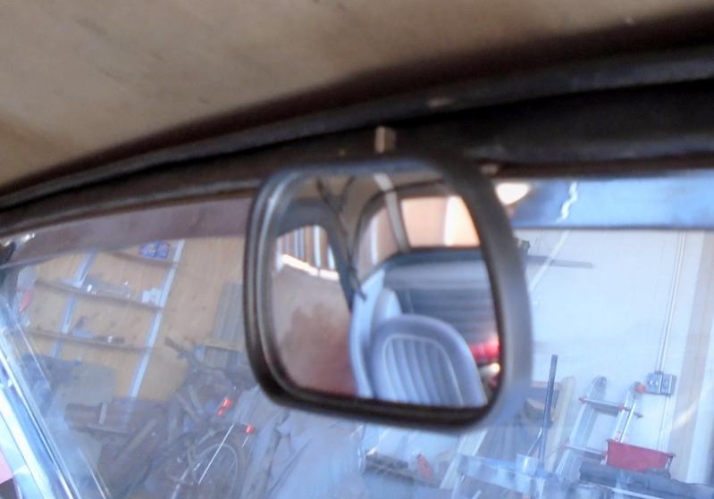

Trevor, I found a small, nifty (3.00) convex mirror at O'Reilly's.
Mounted above the existing dash mirror (missing in this pic), it completely solved my passenger side blind spot problem.

In my opinion and experience, a door mirror on the driver's side is the only thing that will be of any value in today's traffic. The charm of the UK-style "wing" mirrors is lost almost instantly when you try to actually use same. :( As to the passenger side, I also think a door mirror is best. For the last several decades, we've all been spoiled by "Objects in mirror are closer than they appear" on our passenger side mirrors, and rightly so. On the off chance that one could find a decent pair of door mirrors, one with OIMACTTA capacity for the passenger side, you'd be about as well off as you could get short of a pair of mirrors from a semi! :D
And the more I think about it, Thom's idea of the additional convex interior rear view mirror might be a very good idea as well!

Andrew, it's hard to see from my pix but the new inside upper mirror doesn't face rear but to the right, where these cars have the blind spot.
It shows everything along that side, and maybe best of all, it's easy to view and being up and out of the way, kinda looks like it belongs up there.

Thom, I am intrigued by that interior mirror. On a TR or Spitfire, I can see how that might be nearly ideal even with the top up. On a Herald convertible with top up, there's a somewhat significant blind spot; not huge, but there. For that reason, I think I'd still want an exterior passenger mirror on a Herald convertible. No problem on a Herald sedan, though!
