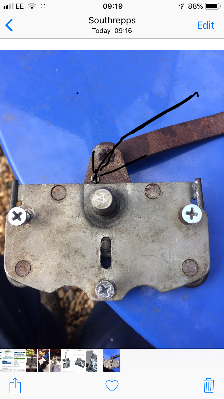

Ray noble
Hi Richard removed my off side assembly some time back and found if I removed the tiny screw the door handle would go forward and effectively lock the door from the inside , thought this was interesting point , sending a picture from when I removed the door mechanism last year
Hope it’s of help. 1958 BN6
Ray

GregW
Platinum
Hi Ray,
Are you sure the lever didn't lock the door with the screw in? I recall the lock is a designed feature. Push the lever one way opens the door, the other locks it.
