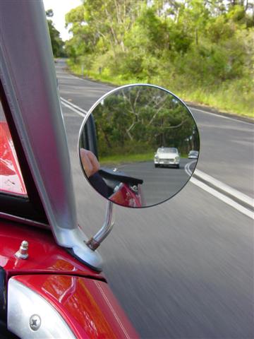

I am still busy at it trying to put my Bugeye back together. I am not looking forward to drilling holes to install a side mirror after my new paint job. I saw a mirror for a bugeye on ebay once that utilized the two holes the screws go through to hold the windsheild post on the driver's side. Has anyone seen one of these before, and can you tell me where I can get one? What mirror was stock for this car - I have a 1960?

Miss Agatha uses a Harley Davidson mirror in the rear hole. Works like it was designed for the Bugeye. As I remember it was $15 and is excellent chrome.

Here is one I just happen to have. Not Miss Agatha.

I bought the same mirrors as per Jack's advice...they look great.

That would work, they have several styles like that. When I got mine it was $15 bucks from Harley Store. They make a right side and a left side.

Soooooo, you just remove the "screw" in there and run the mirror into the hole? Nut it from the inside? Seems too easy. What about a nut on the outside to tighten against the windshield frame? I like the look of wing mounted mirrors but I'm told they aren't all that functional and you have to have holes in the fenders. Yuck. Sorry for the questions, hate buy stuff that doesn't fit if I can help it.

The mirror has a bit of a taper thing that goes into the windsheld mount hole to hold it just so.

I think these are the ones Jack has.
Price went up a few bucks. I need to order a couple, although I might opt for the skull.
HMHD.com
Part #91930-92T

That's them, yep price has gone up a couple.

Got 'em. Fit okay. Was able to mount for good usabilty. I think they look alright. Still might someday get fender ones though.

Look darn good to me. Now keep in mind I think they will hit your side curtans unless you twist em out of the road which is fine for most of us guys. Not much top up time.

The ones I got off ebay look okay. These are not left/right specific, I believe the official HD ones are? I have a large Harley dealer right up the road from me, they had these mirrors in stock but they had Harley Davidson written on the stem $20 each. The ones I got are a stem, the mirror head slides on and is secured by a set screw so you can rotate the stem in the mounting hole, the mirror can spin around the stem and slide up or down, then the mirror itself can be pivoted. Even so I had to fiddle to get a decent view without the mirror ending up behind the window frame or too low to interfere with the door opening. I'll wax the daylights out of them in the hope of keeping them pretty for a while. Drove the car last night and they function well, good view, easy to reach over and tweak either one as you drive. I'm okay with them. They look like they belong I think although the wing mounted ones look cooler (IMHO), fender mounts have some disadvantages: trying to work around them when tinkering in engine bay and questionable functionality as useful mirrors, the need to drill holes. These are easily ditched if needed. Not sure the side curtains will sneak between them and the window frame but if not, the few times I have the top on, I can just push them out of the way.
