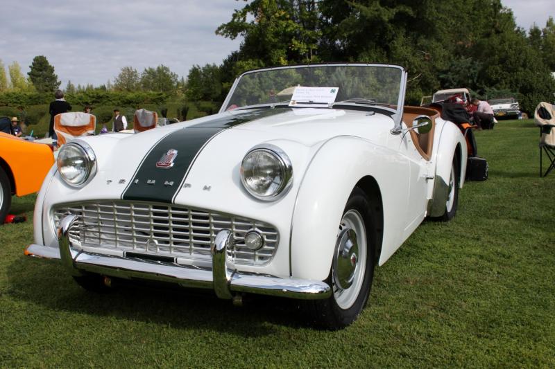

PatGalvin
My car didn't come with any mirrors installed (and no holes). So, I opted for what I think is a very cool mirror at the windscreen pillar that doubles as a Dzus fastener for the windscreen pillar. Easy to adjust (within arm's reach) and doesn't vibrate like the rear view mirror does.

charleyf
Pat,
do you have any sight problems with the side curtains on the car?
Charley
