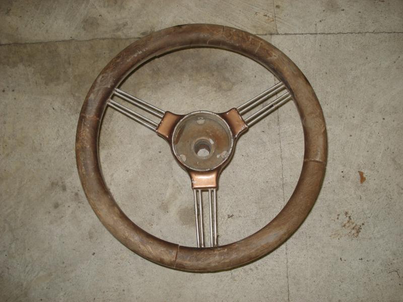

I wanted a smaller wheel that was maybe something that looked authentic and I came up with this style. It also allowed me to stain it to match the dash and shift knob color.
Man that is neat-:encouragement:

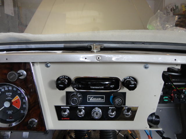

Are those A/C vents below the dash and centre where the speaker bezel would normally be ?
Patrick67BJ8

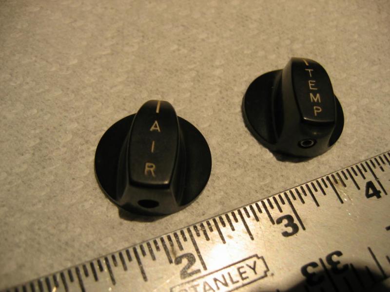

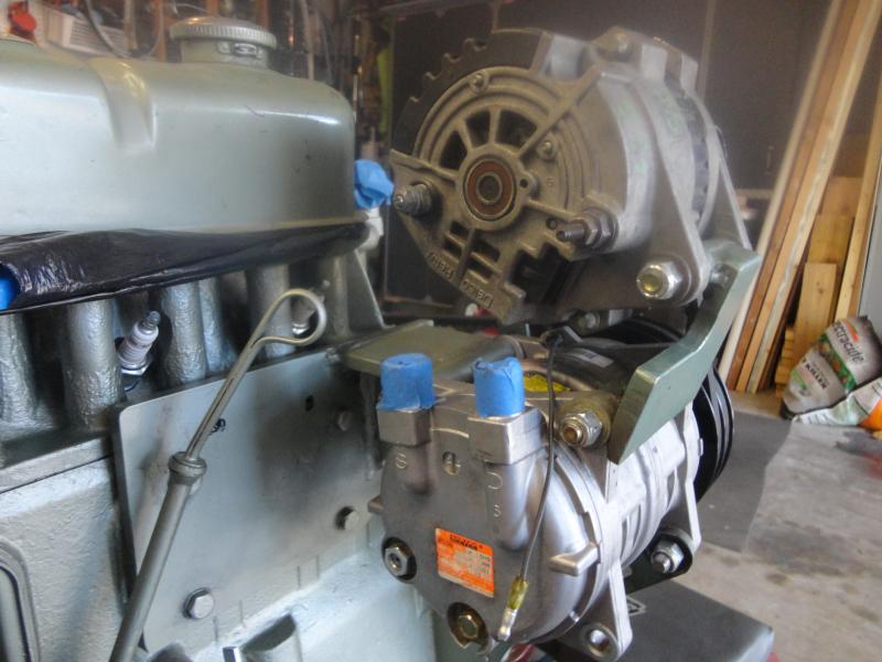

Yes. I had a Factory AC unit(made by BMC Coolair, Miami, FL), installed for several years and sold it and built/installed a custom unit. I paid for the development of the special bracket that holds the alternator and compressor that replaces the original generator bracket. The control faceplate replicates the original facial panel faceplate(I already had the holes in the facial from the original control plate). I located a source for the skirted knobs and had them engraved as the originals were. A custom condenser was also fabricated.
