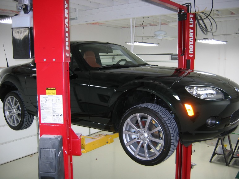

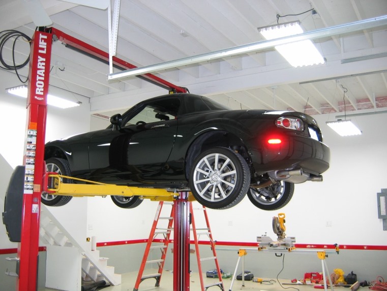

I knew if I dug around long enough I'd find these pictures. If you look at the columns on the lift you will see that they are angled out as opposed to directly facing each other. When go from one picture to the other, you can also see that the front and rear arms for the lift are different lengths. I'd banged enough doors into the columns on a symmetrical lift to know that when I was spending my own money on a two poster, it would be an asymmetric lift. The elongated black boxes on each column house the lift controls.
These pictures were taken when we were finishing out the shop and hadn't moved any of the "car stuff" into the shop yet. Everything was still covered in dust from the drywall work. When my wife came up in her Miata, we decided to toss it up on the lift to see how well it worked and for a worms eye view of her car. This was the first car to take on ride on the lift.
