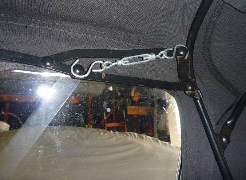

If the side bows are hanging down you may want to add a tensioner on each side:

Thanks, Mike and Steve. That procedure worked very nicely, requiring only some effort to press the front bar down on the windscreen to secure the latches. The PO supplied two handmade S hooks to serve as tensioner's such as Steve suggests. They can be slid along the rails to snug down the hinged bow apparatus. I keep a little sketch to help me remember how they install. I also made myself a note on installing the hood for the day when I want to do it again.
