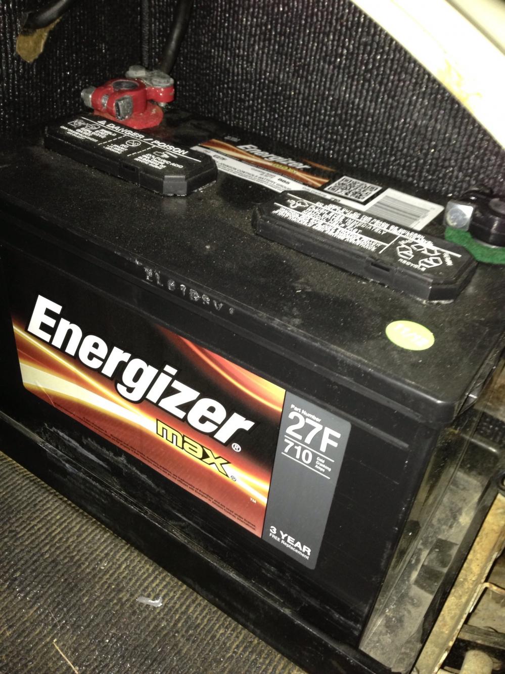

I just recently purchased an Energizer Max 27F for my BT7, found it at Sams Club. It fills the battery tray better and also places the terminals towards the fender for a cleaner look:
Patrick67BJ8
The 27 and 27F are different because of terminal locations and of them works great for Neg ground cars.
