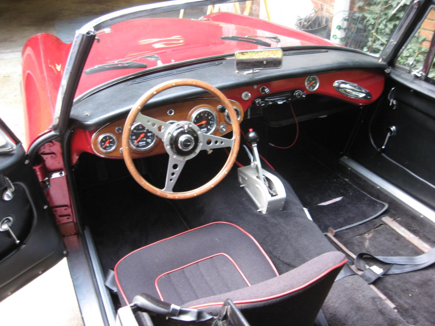

i believe that is the wheel that i bought and with the correct adaptor from moss no machining is necessary. it is 14 inches in diameter!

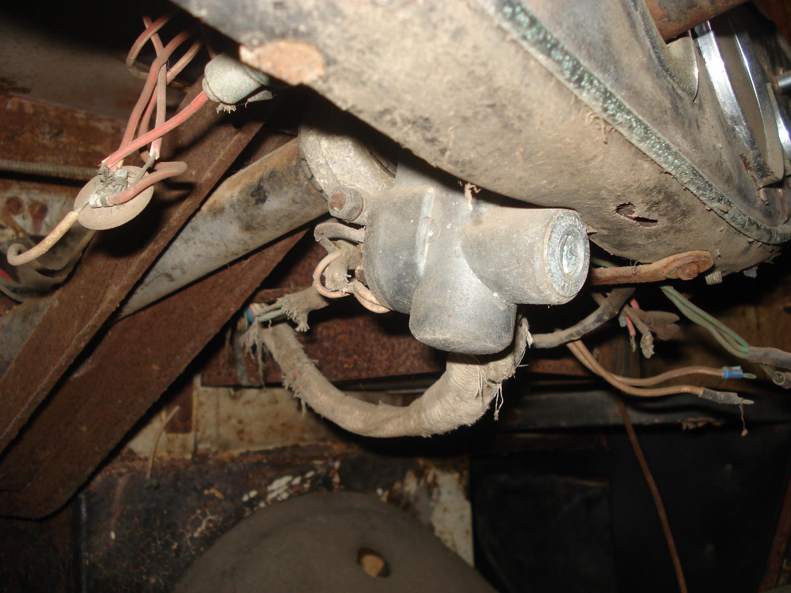

No, Richard is talking about adjustable for height, not length. I wasn't follow him at first either, but yes, he's right (don't tell him I said that...).

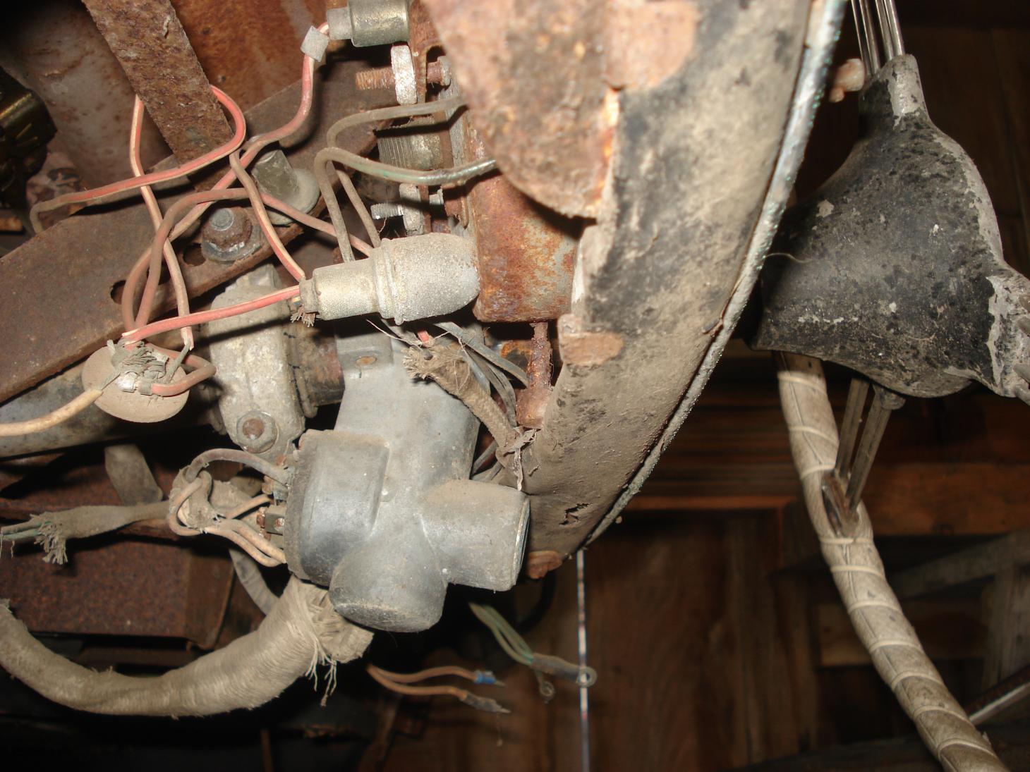

I must have a picture of that somewhere...
Coincidentally, it's the picture that I used to show someone else the area of the non-sdjustable column hub that needed to be ground out to fit the trafficator. Anyway, the aluminum clamp that supports the column can be suspended from one (1) of three (3) pairs of holes in the column support bracket.
healeyblue
I'll piggy back on randys photo showing the aluminum (aluminium) clamp with the bolt and the ever important steering column brace (which I almost forgot to put back on on the longbridge build). My photo also shows the German delivery steering column lock mentioned earlier.
