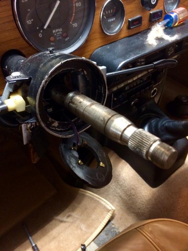

Since I'm home and looking to keep busy, I decided to tackle a long dreaded repair to the excessive movement in my steering column.
On Friday I finally got it done. A job that I thought was going to be a nightmare turned out not so bad after all.
I left the old bushings in place and installed new delrin bushings on the top and bottom of the steering shaft.
No more squeaks, no more movement.
The part I found most difficult was the removal and reinstalling of the turn signal cancelling clip.
Pic below shows steering shaft pulled out ready for cleaning with some steel wool and solvent prior to sliding the new bushing on.

Wrenching is definitely a great option as we are spending more time at home.
I did my steering wheel bushes the same way, just slid them on without dismantling everything. Was amazed at the difference it made, whole steering feel went from sloppy to precise.
yes, I found the same difference.... I should have done it when I did the frame-off restoration.

I drove a TR4a for about ten years, and my TR250 for several years after I restored it before (I think through this forum) I got the idea to do the bushings. I thought they "just all were like that"
