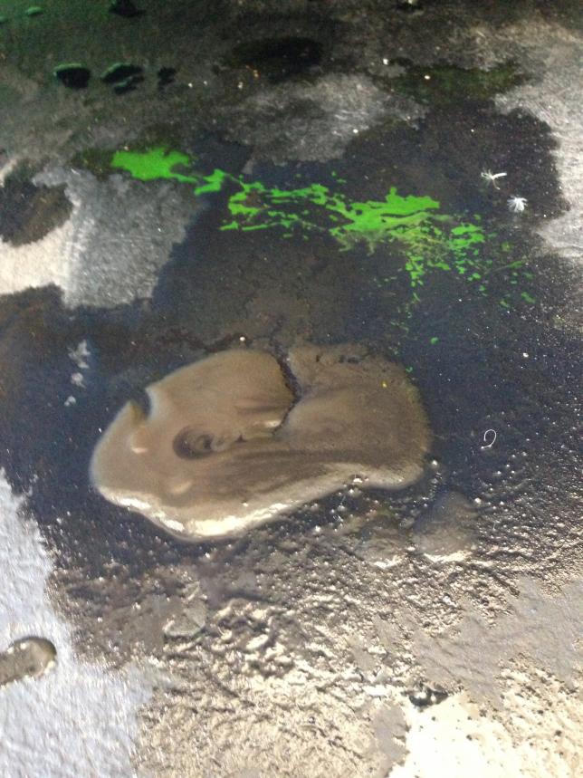

I recently changed the oil and filter, cleaned out the sump and changed the gasket, and put in 20w50 oil. The oil pressure is now at 100 at startup but goes down to about 60-70 after a bit of warming up. Then there this:
The thick brown puddle next to the coolant is worrisome and appears to be coming from the rear engine seal area. My first step will be to adjust the oil pressure release valve, but I'm worried about where this sludge is coming from. Do you think it's due to the increased pressure? I don't seem to have any head gasket symptoms, but I was planning on doing a test for combustion gas just to be sure. Thoughts?

If the oil leak is due to the high oil pressure it would indicate that you have some major opening in the pressurized syste. This would have to be something like a missing or loose oil galley plug. High oil pressure by itself is not going to come out through seals as the block is not pressurized by the oil pump. However, if you have something like a failed valve cover gasket, the supply to the top of the engine can spill out and easily run down the block. Severe blow by from a worn engine can also cause oil leaks, these being through the seals.
My suggestion would be to go to the parts store and buy a small vial of the UV dye that you can add to engine oil. While there buy more oil and some engine degreaser. Completely clean the engine and surrounding areas. Add the dye and make-up oil to the engine and at dusk idle the engine to operating temperature. Use a blacklight (available from the home center) to illuminate the engine. The dye will glow and indicate where the leak is.

I will do that to try and pinpoint the leak, although I'm more worried about the color and consistency of it.
As for the oil pressure, this is my first oil change since I bought the car and the engine was supposedly rebuilt not that long ago. Do you think the 20w50 is too thick?

I've seen oil get that muddy brown color when coolant gets mixed in with it.
poolboy
It's an emulsion. Something, probably pressure, forced the 2 liquids to combine. Oil and coolant would be my guess, but how and where it happened ?
PatGalvin
Having very recent experience with coolant mixed with oil, I can say that my first reaction to the photo was that you had water in your oil. It creates a mayonnaise consistency in your oil pan (and in your rocker cover, if you run long enough).

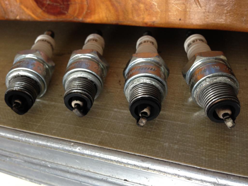

Those are the possibilities I'm more worried about. Although I don't see any signs on the dipstick. I do get a little bit of moist carbon spitting out of the exhaust at startup, but it goes away when warm. I still haven't gotten to the parts store, but I pulled the spark plugs and they look like this (1-4, left to right):
Those plugs probably have about 20 miles on them after a full tune-up and some carb work.

It does look like a water/oil emulsion. Where it came from? Who knows. Drive a bit and see if it comes back before starting to worry. Could have been from a disconnected valve cover line that drained off or something like that.

The plugs look pretty good too for a starting point, nothing I would be worried about.

Looks like #1 plug is either running rich or has some blow by. Is it powdery or wet?

Also, the plug is powdery. Suggests rich, right? Why would only the #1 be rich?

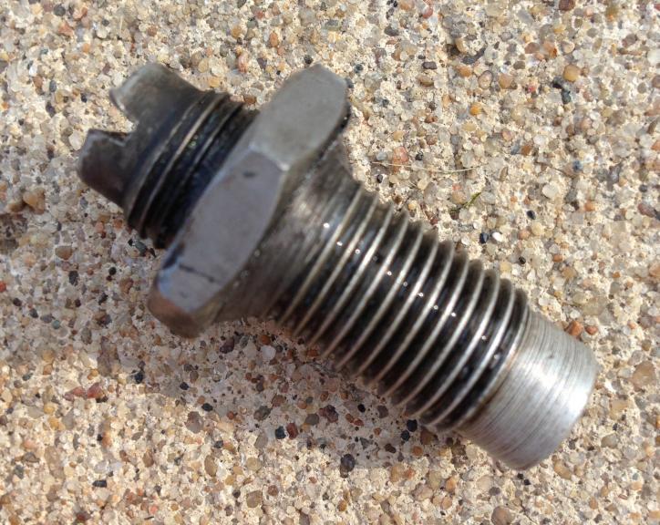

The OPRV is indeed 70. However, it seems as though my adjusting screw isn't stock:
It's supposed to be adjustable but mine has a hex lead-welded on. The Big 3 don't seem to stock them either.
Merlin63Tr4
I think what you are looking at, that looks like a weld, is the lead wire that is used as a seal.
A little heat should free that hex locknut.

Oooh ok. I give that a shot. What should I use instead to seal it? Felt washer?
